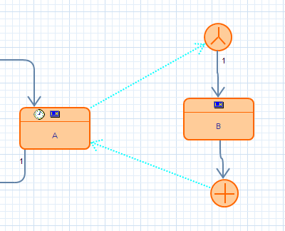

I have implemented a Custom Node Collapse Feature. When a particular node is collapsed, it will delete set of nodes and links from a diagram. As you can see in the diagram below, if a node "A" is collapsed, split node (upper circle in the diagram), node "B", and join node (lower circle in the diagram) shall be deleted.

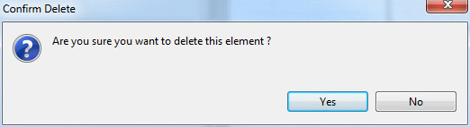

There is no problem in deleting. But I get delete confirm dialog as many times as the total number of Nodes and Links that I am deleting!!!
The following is my code in the Custom feature. Is there any (better) way for showing this "delete confirmation dialog" only once while deleting all these nodes and links??

I managed to solve this by overwriting "delete" method in my Custom Delete Feature.
BR
Surya
Re: delete confirmation dialog [message #900708 is a reply to message #900244] Wed, 08 August 2012 04:58 Go to previous messageGo to next message
Sorry for this late answer.
But probably the better way is to set a MultiDeleteInfo on your delete context.
BR,
Matthias
Re: delete confirmation dialog [message #1456516 is a reply to message #900708] Thu, 30 October 2014 08:46 Go to previous message
As in the previous reply, this piece of code does what you asked:
	public void delete(IDeleteContext context) {
		Validate.notNull(context);
		Validate.isInstanceOf(IDeleteContext.class, context);
    ((DeleteContext) context).setMultiDeleteInfo(new MultiDeleteInfo(false, false, 0));
Simone
