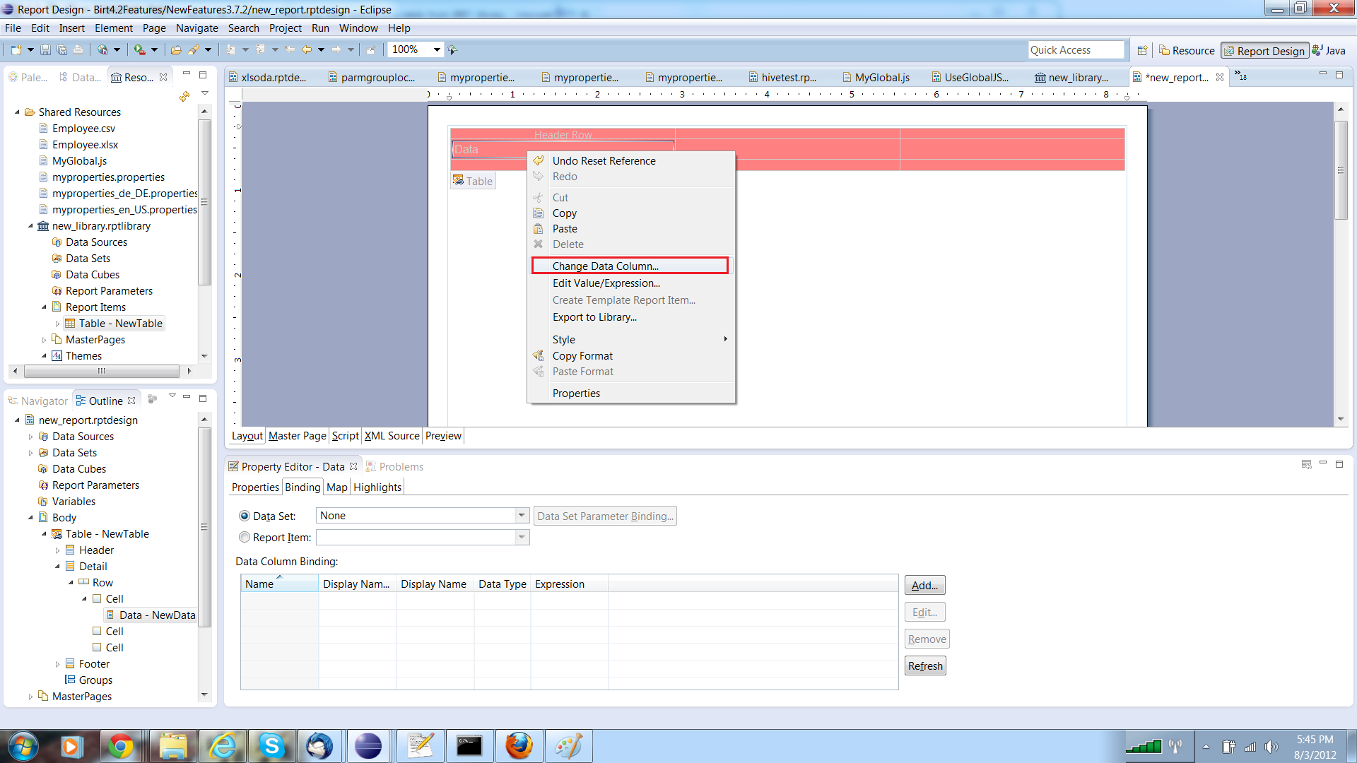

I am not to fond of how we have this implemented today, but once you add
the table from the library, bind the data set in the binding tab. Next
right click on your data items in the table and select "Change Data
Column" to specify one of your bound data set columns. See attached image.
Jason

Re: problem in binding data source to a table from BIRT library [message #900150 is a reply to message #900094] Sat, 04 August 2012 13:54 Go to previous messageGo to next message
Thanks a lot, Jason!!!
I have checked by adding data element at table cell and its working as per my requirement.

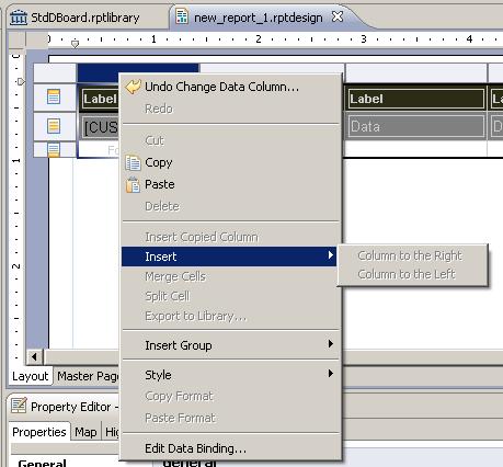

Is it correct to use the library table of 10 columns when table of 7 columns is required in report and .rptdesign gives errors for "value expression"?
Re: problem in binding data source to a table from BIRT library [message #906121 is a reply to message #905952] Fri, 31 August 2012 12:50 Go to previous messageGo to next message
I am not certain what you mean by this:
> If I have to create tables of choice for either 1/2/3 headers, then I
> have observed that since grouped column inputs are mandatory, I have to
> create 3 separate tables with no. of headers as 1/2/3
I do know of a way to delete the bindings. If you can change them why
not just put in something like "" for the expression?
Jason
On 8/31/2012 7:06 AM, g g wrote:
> Hi Jason,
> I started working on table library by putting table of vaious sizes (ie
> no. of columns) in it.
> Also I have tested __document part u have mentioned and its working for
> our requirement.
> create 3 separate tables with no. of headers as 1/2/3 headers and 4th
> table for group of users who do not require the headers at all. So I
> have to create 4 tables for a given table size in library. Is their any
> other way to achieve this requirement in library?
> Also if I create 3 tables say with size 10,20,30 columns in library
> (each with have 1-header/2-header/3-header/no-header version). If I use
> column-10 table with 2 headers to create the report with 7 columns , I
> face following 2 problems.
> 1. Once I do data binding for a column, I can change the binding; but
> can't delete it.
> 2. If I hide the column instead as I do not have permission to delete
> it, it still gives "value expression" errors for columns not used/hidden
> and report works fine.
> Is there any way, by which I can atleast I can delete binding to the
> library-table once its done?
> expression"?
Re: problem in binding data source to a table from BIRT library [message #906271 is a reply to message #906121] Fri, 31 August 2012 21:33 Go to previous messageGo to next message
Sorry for the confusion.
What I meant by
is
If I want to create table of 10 columns, I have to create 4 tables in library as follows:
table with 10 columns, no header - no footer (plain table)
table with 10 columns, one group header - one group footer
table with 10 columns, two group headers - two group footers
table with 10 columns, three group headers - three group footers
Then users can use the table as per their requirement of no. of headers.
Since I have to create tables of 3-4 different column sizes and for each column size I have to create 4 tables in library (the mentioned above plain + 3 with various no. of group headers ), it will increase no. of tables in library 4-times. so is their any way to achieve this requirement differently?
