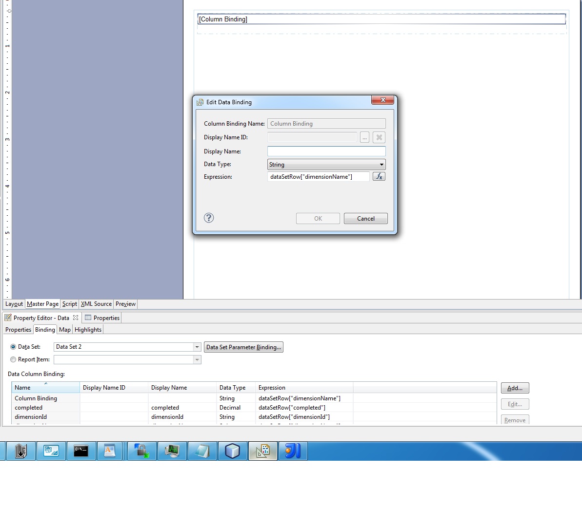

Re: How to set text in master page header using data from report? [message #899290 is a reply to message #899282] Tue, 31 July 2012 07:19 Go to previous messageGo to next message
Did you try a data binding? see the attach screenshot
