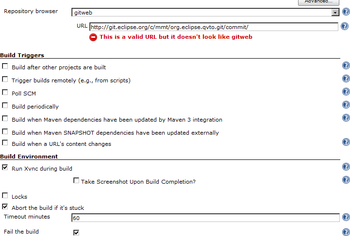

<div class="moz-cite-prefix">Hi Nicolas<br>
<br>

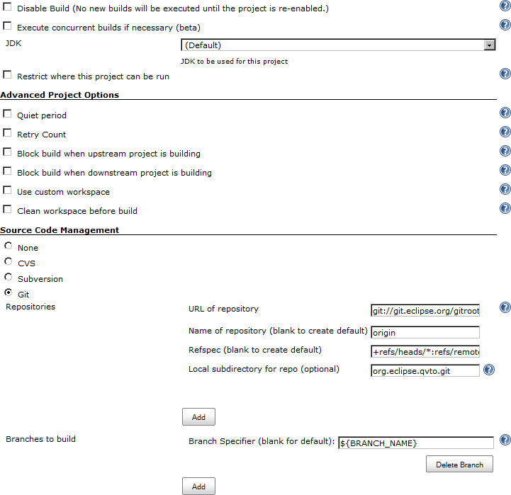

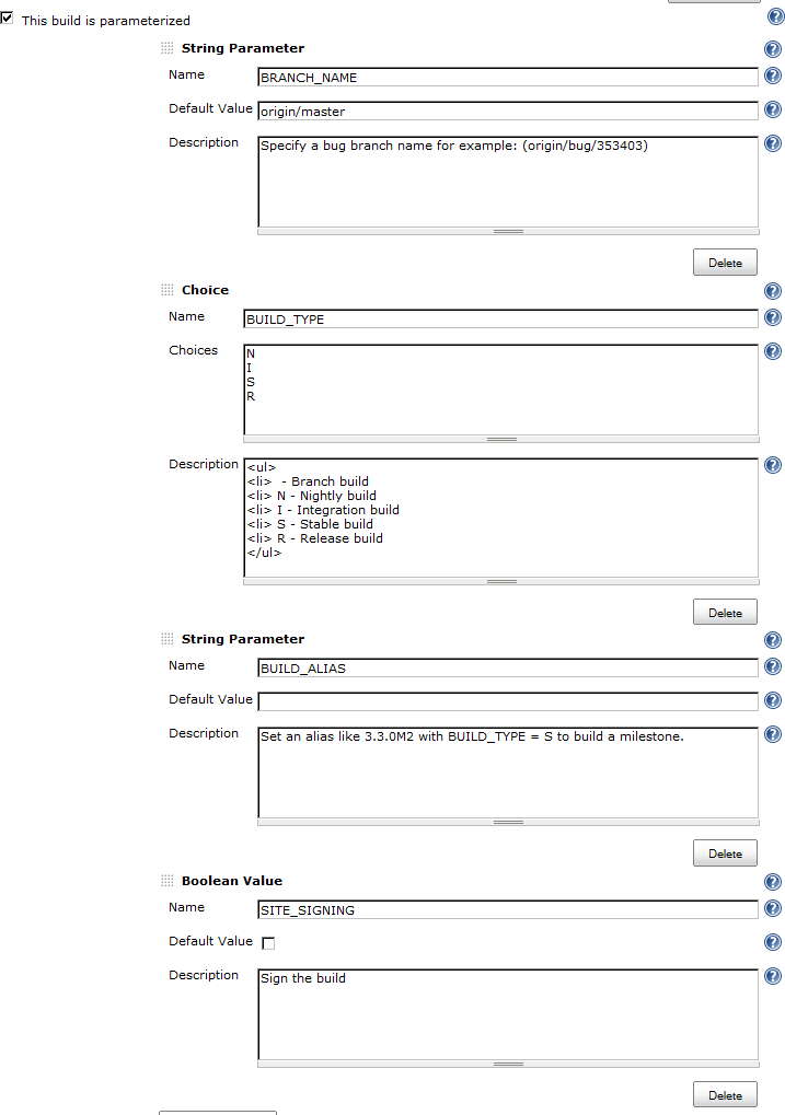

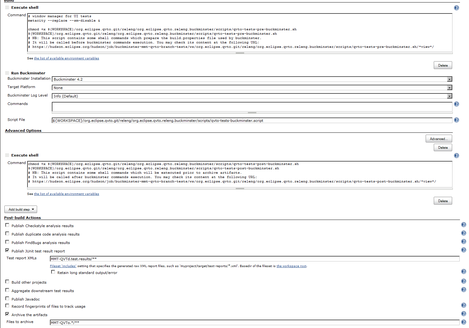

It all happens via the BRANCH_NAME parameter.  Below are some
screen shots of what you could see in Configure<br>
<br>
<img src="http://www.eclipse.org/forums/index.php?t=getfile&amp;id=10933" alt=""><br>

<br>
<img src="http://www.eclipse.org/forums/index.php?t=getfile&amp;id=10934" alt=""><br>
<br>
<img src="http://www.eclipse.org/forums/index.php?t=getfile&amp;id=10935" alt=""><br>

<br>
<img src="http://www.eclipse.org/forums/index.php?t=getfile&amp;id=10936" alt=""><br>
