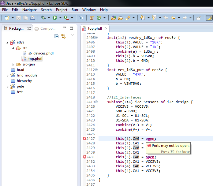

I have a strange case where I open a new runtime instance of eclipse to test that my new validator check method is working, and it correctly reports the error. However, when I copy and paste the test case source from the eclipse runtime project, into a JUnit test case using external files of my model, the JUnit passes all tests. It's a copy and paste example (that is too huge to copy into this forum) so I have no idea why it wouldn't be working. It seems to me that the *.xtext.tests project is not aware that I made changes to the validator in the *.xtext project. Here's what I've tried:

The errors are properly reported in the editor UI (see attachment).
I am using eclipselabs/xtext-utils for unit testing.
Here's my testcase which incorrectly does not report any errors, but it should be reporting the same two errors as the editor:
