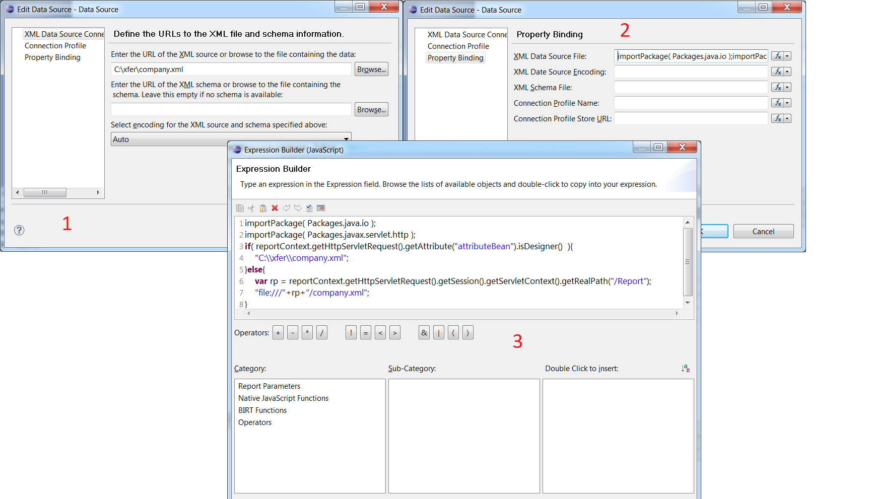

Hello!
I'm hoping this is an easy question!
We have the BIRT viewer running with tomcat and I've made a simple report that uses a XML file as its data set.
I was imagining we'd use a third party application to generate the XML file the report would use as its data set. This works out with a single user because it doesn't matter if the file is over-written each time they want to view the report with "new" data. However, we don't need a report only one person can run, we will have multiple making use of this report, possibly at the same time.
As far as I know, our tomcat server will not have access to our databases thus the need for the source XML file.
Is it possible to create a birt report that can be run by multiple users, simultaneously that uses a passed XML file as the source for its data?
Any help is greatly appreciated!
Dave

Sure you can do this. There are several ways this can be done, using a
little script to change the file name, pass in an xml stream, or use
property binding. Look at the attached screenshot. Notice the fx
button on the image labeled 2. The expression is represented in image
3. In this case I am looking in a report directory, but I could have
deleted this entire expression and just selected a string parameter that
you pass in to the report as well.
Jason

Perfect! Thanks so much for your help!
