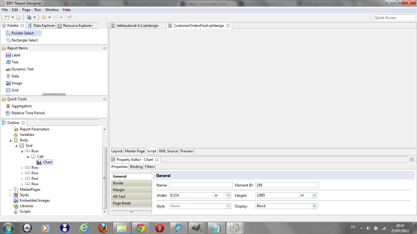

I recently downloaded RCP Birt designer 4.2, and i noticed the script tab remains blank, whatever the report items selected. I do not have this problem in 3.7.2 and earliers.
And in the outline view on the left, in 4.2 if i try to directly open my existing report scripts, i get the same issue: the report view is blank, and i can't access to items events such onCreate, onRender, etc.
It happens both with reports created with a 3.7.2 RCP designer, and new reports created with RCP 4.2

In the 3.7.2 build were you using the all in one? or the RCP Designer.
I was under the impression that we disabled scripting in the RCP
designer but not the all in one.
Jason

I used RCP designer in 3.7.2, and in earlier versions as well. I have just tried the all-in package 4.2, your are right i can access to my scripts in this one

Thanks for the reply. I do not often use the RCP version but I do
remember when we first created that package that we were planning on
disabling the script tab as this version is suppose to be simplified.
