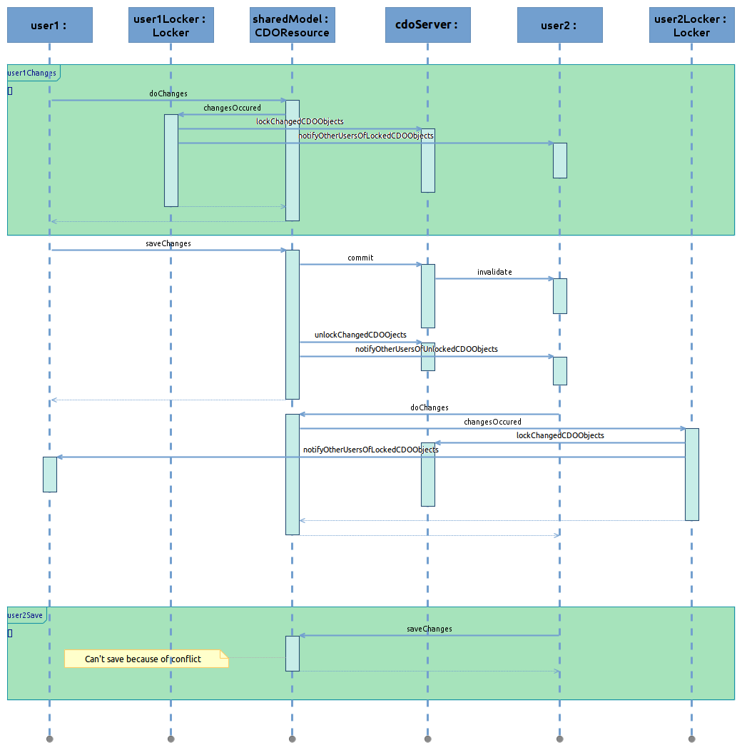

After the user having done the changes save its changes, we commit and
just after we send a unlock message also through a
RemoteMessageNotificationRequest. Like that the other users update their
cache of locked objects by other, and are allowed to do changes.
The attached screenshot2.png show the normal workflow.

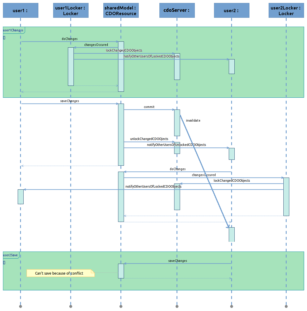

But the issue comes from the fact that RemoteMessageNotificationRequest
and CommitTransactionRequest are not sync, then remote users can
receives the unlock message before the InvalidationRunnable execution,
between the unlock message and the InvalidationRunnable execution,
remote users can do changes without being rollback by the Locker then we
come to a conflict.
The attached screenshot.png show the conflicting workflow.
This last image show that on user2 the invalidation
(InvalidationRunnable) is executed after the unlock message reception
then between these 2 events user2 have the permission to do model
changes like the CDOObjects are unlocked. But during the
InvalidationRunnable execution, some conflicts are detected and can't be
resolved then at the end user2 can't save its shared resource (CDOResource).
I don't know how to ensure that the InvalidationRunnable be done before
the unlock on the CDOServer and before the unlock message reception?

The lock notifications distributed by CDO 4.1 should fix this problem or do I misunderstand it?
Cheers
/Eike
>>> RemoteMessageNotificationRequest and CommitTransactionRequest are not
>>> sync, then remote users can receives the unlock message before the
>>> InvalidationRunnable execution, between the unlock message and the
>>> InvalidationRunnable execution, remote users can do changes without
>>> being rollback by the Locker then we come to a conflict.
>>> be resolved then at the end user2 can't save its shared resource
>>> (CDOResource).
>>> before the unlock on the CDOServer and before the unlock message
>>> reception?
>>> We have think about using the timestamp returned by the
>>> CDOTransaction.commit()::CDOCommitInfo and send it with the unlock
>>> message then when the user2 receives the unlock message it wait a
>>> CDOViewAdaptersNotifiedEvent with the correct timestamp from the
>>> InvalidationRunnable.
>>> What do you think about this last solution?
>>> Best Regards.

Hi Eike,
I have seen the new lock notification in CDO 4.1, but it doesn't solve
our issue, in our use case to avoid conflict, we want to have a commit
request followed by a unlock request be atomic and ordered but currently
with our use case having many users commiting their changes in a short
time, a unlock request can be managed by the server before a commit
request, especially with the invalidation step at remote users.
Do you know a mean to have CDOTransaction.commit() call blocked until
all remote users clients have their invalidation step done? Like that we
could unlocks CDOObjects after the commit to allow remote users do
changes without conflicts.
P.S. : I have attached a JUnit test case to show in debug the issue,
putting a breakpoint in InvalidationRunnable to retain the main user
changes integration and leaves the remote user do its changes, debug
step by step the InvalidationRunnable previously stopped and we can see
conflicts, the remote user is allowed to do changes because the
"user1Locker.unlock();" has been executed just after the commit
"user1CDOTransaction.commit();".
Best Regards.

Hi Eike,
We manage ourself the unlock because in our application we distinguish
implicit lock (lock taken by changing a CDOObject) of explicit lock
(lock taken explicitly by the user without CDOObject change). Then we
manage locally on each client a cache of implicitly locked CDOObject and
one of explicitly locked CDOObject and on commit, we release ourself the
implicit locks but not the explicit ones.
In fact in our use case we would like to have autoReleaseLocks only for
implicit locks, then I just understand that I needs a feature request.
Do you agree this feature request for our use case?
Yes the test case show two signals.
Best Regards.

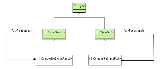

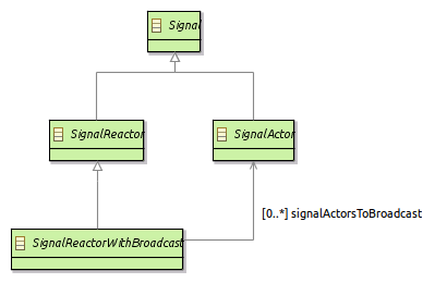

I have thinked about a new signal type, a
SignalProtocol.SIGNAL_COMPOSITE (CompositeSignalActor and
CompositeSignalReactor) which could be composed of signals to manage the
atomicity and have a SignalReactorWithBroadcast abstract class
inheriting SignalReactor to register all SignalActors to broadcast to
other clients in a list and have these signals broadcasted in a
CompositeSignalActor to be atomic. Like that we could ensure the
atomicity and order of notifications in our use case and the use case of
https://bugs.eclipse.org/bugs/show_bug.cgi?id=355045 , unfortunatly it
is very impacting. What do you think about that?

Re: [CDO] Pessimistic lock with EMF Transaction [message #900844 is a reply to message #900331] Wed, 08 August 2012 13:13 Go to previous messageGo to next message
Am 06.08.2012 16:06, schrieb Esteban Dugueperoux:
> Hi Eike,
> I have studied a little more our issue, at the beginning I have tried to write a quick and dirty code to have a list
> of CDOObject to unlock on commit, like the "lock on commit for NEW CDOObjects" feature do (see
> https://bugs.eclipse.org/bugs/show_bug.cgi?id=355045 ). Like that the SignalActor sent to the CDOServer is atomic to
> do the commit and unlock process, but there is still the commit and lock notifications which are not atomic and can
> arrives unordered on other clients.
That's by design and more (synchronous) coupling between the clients of a server is not desirable in general.
> There is the same problem for "lock on commit for NEW CDOObjects" feature
> (https://bugs.eclipse.org/bugs/show_bug.cgi?id=355045 ), In comment
> https://bugs.eclipse.org/bugs/show_bug.cgi?id=355045#c2 Caspar talks about this issue which exists yet today on the
> master, a LockNotificationIndication can be received before a CommitNotificationIndication.
> Then our issue is a general one for different use cases which needs to be ensured of SignalReactor reception ordering.
If this is really an issue then it should be solved by refactoring both CommitNotification and LockNotification signals
such that the former can reuse the logic of the latter in order to send them atomically (per client!).
Affected are the calls to sendLockNotifications() in TransactionCommitContext.updateInfraStructure() and
sendCommitNotification() in TransactionCommitContext.postCommit().
> I have thinked about a new signal type, a SignalProtocol.SIGNAL_COMPOSITE (CompositeSignalActor and
> CompositeSignalReactor) which could be composed of signals to manage the atomicity and have a
> SignalReactorWithBroadcast abstract class inheriting SignalReactor to register all SignalActors to broadcast to other
> clients in a list and have these signals broadcasted in a CompositeSignalActor to be atomic. Like that we could ensure
> the atomicity and order of notifications in our use case and the use case of
> https://bugs.eclipse.org/bugs/show_bug.cgi?id=355045 , unfortunatly it is very impacting. What do you think about that?
Coupling operations of one client (such as commit) to the execution of resulting notifications in (all) other clients is
generally not desirable. For example it's unlcear how to deal with problems in receiving clients. We don't want to
change the framework to mandate this approach.
If your specific application absolutely needs this and you accept all the drawbacks I could imagine of a comparingly
simple solution:
The Net4j signalling design does not allow for synchronous and asynchronous signal implementations in one class (we
can't make the response part optional). But the CommitNotificationRequest/Indication classes are very small and trivial.
You could implement (and contribute) an additional pair of signal classes that extend RequestWithConfirmation and
IndicationWithResponse, respectively. Then you would add a repository option for the asynchronicity of the commit
notifications and respect it in TransactionCommitContext.postCommit().

Re: [CDO] Pessimistic lock with EMF Transaction [message #901047 is a reply to message #900844] Thu, 09 August 2012 10:14 Go to previous messageGo to next message
Hi Eike,
Where do you see the coupling between clients of server?
If there is a design mistake it is current, because we mix commit and
lock aspects in a same request (i.e. the CommitTransactionRequest).
I don't know the initial purpose of "lock on commit of NEW objects"
feature (https://bugs.eclipse.org/bugs/show_bug.cgi?id=355045), perhaps
Caspar De Groot could tells us what was the initial purpose of this
feature and why a CommitTransactionRequest followed by a
LockObjectsRequest was not sufficient?
Perhaps Caspar has encounters a similar issue to our issue (we execute a
CommitTransactionRequest followed by a UnlockObjectsRequest), where
other users can take the lock on concerned objects between the execution
of the LockNotificationIndication and the CommitNotificationIndication
because the network packet routing has done reception order of
LockNotificationIndication before CommitNotificationIndication.
We could imagine other use case with other request/indication
combination, for example with a call to LockObjectsRequest followed by a
CloseViewRequest to have a subset of objects to be locked on View
closing, the server could receives the second request before the first
then the LockObjectsIndication execution will failed because of the
opened View missing.
I'm agree that the needed "atomicity/signals order" is per client.
For my use case I can do a minimal refactoring to have "unlock objects
on commit" feature as do Caspar in
https://bugs.eclipse.org/bugs/show_bug.cgi?id=355045 and change the
sendCommitNotification() in TransactionCommitContext.postCommit() to
ensure correct notifications arrival order on other clients.
But it is a specific coding and not very generic, every time a user want
to ensure order/atomicity between Indications reception, he must fork
the first Indication/Request code pair to manage aspect of the second
Indication/Request pair, for example for the use case of "lock on View
closing" the user must fork the CloseViewRequest/CloseViewIndication to
manage the lock aspect, as Caspar do currently for "lock of NEW object
on commit" and as we want to do for "unlock on commit".
Do you agree that the need to have SignalReactor reception order ensured
according to their counterpart SignalActor is needed on
A new type of net4j SignalActor/SignalReactor pair, which we could call
"SIGNAL_COMPOSITE_SIGNALS" could compose a sequence of SignalActor
(Request in CDO context), for exemple a CompositeActor composed of a
CommitTransactionRequest followed by a LockObjectsRequest, could ensures
the request reception order on the cdo server.

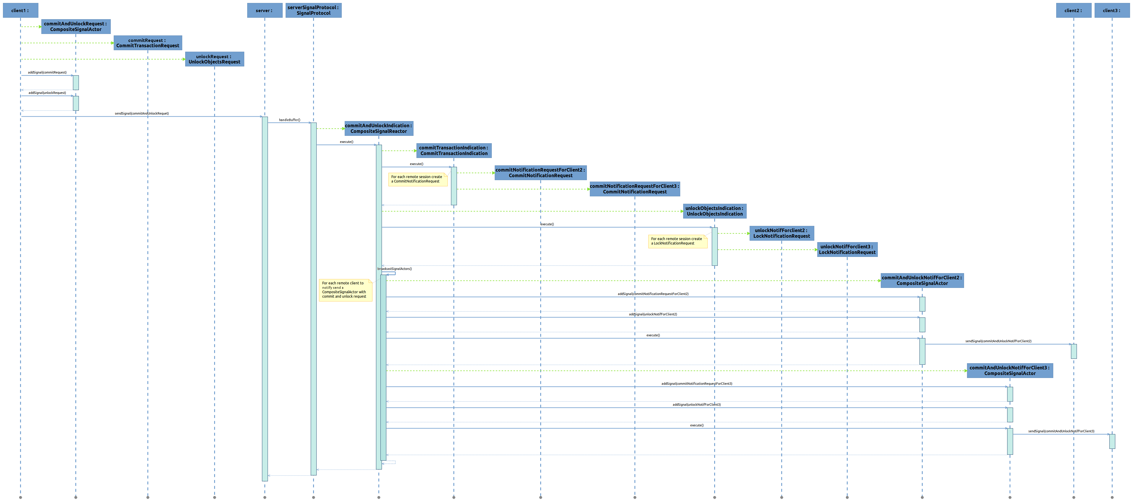

I have attached diagram explaining the composite signal solution :
- the Net4j_Composite_Signal.png explains the use of the Composite
pattern to have a sequence of Signal in a CompositeSignal sent to remote
- the Net4j_BroadcastSignalReactor.png defines a abstract
SignalReactorWithBroadcast for SignalReactor wanting to send SignalActor
to other clients
- the Composite_Signals_With_Broadcast_interaction.png interaction
diagram shows a example of use of these new types.
Best Regards.
to other clients
Best Regards.
to other clients
Best Regards.
to other clients
Best Regards.
