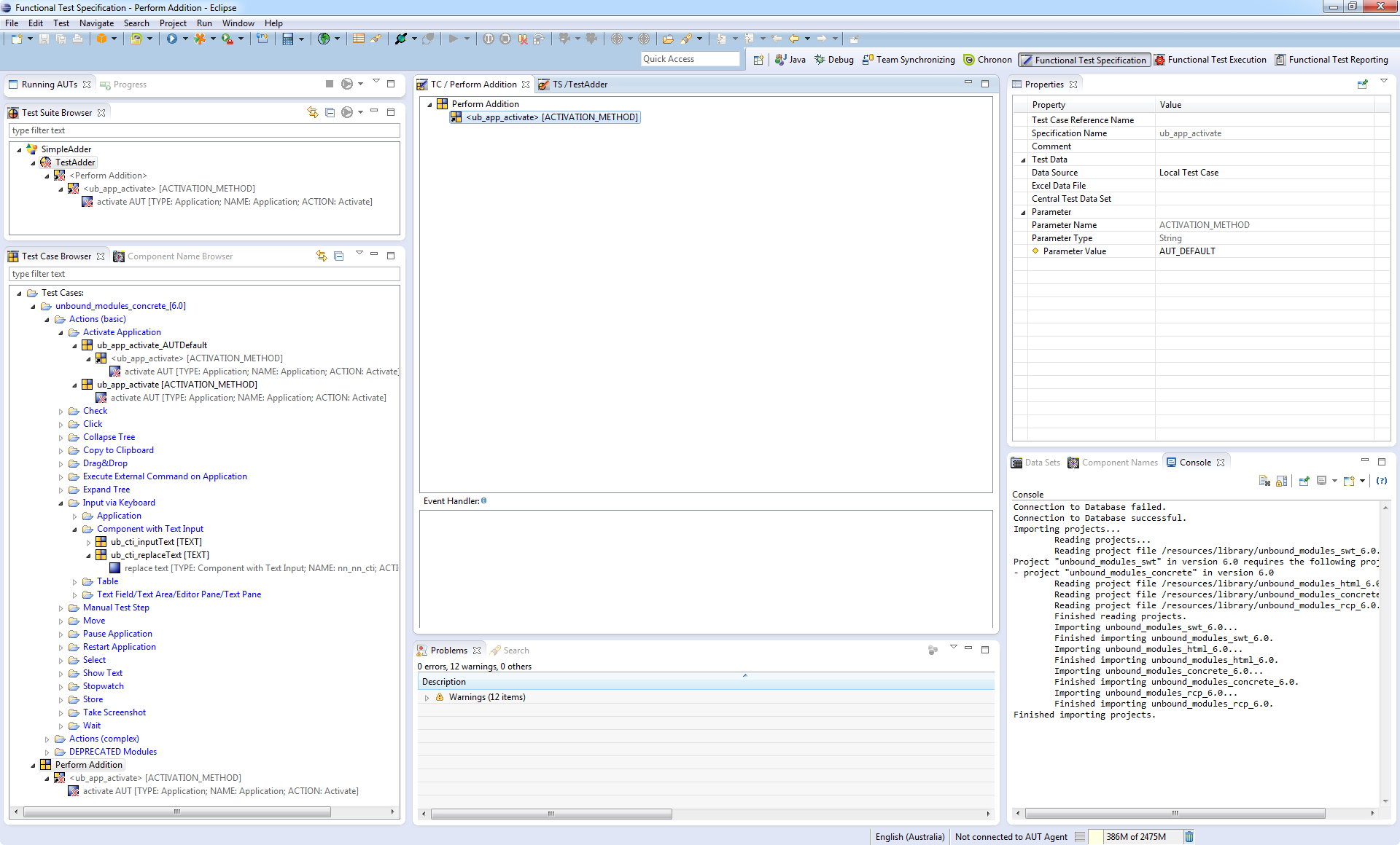

Still got problems with the plugin!
Created empty PostgreSQL database which imported default projects. Created project and defined activation step in new test case. As you can see, everything looks fine (ref attached Screen1.png)

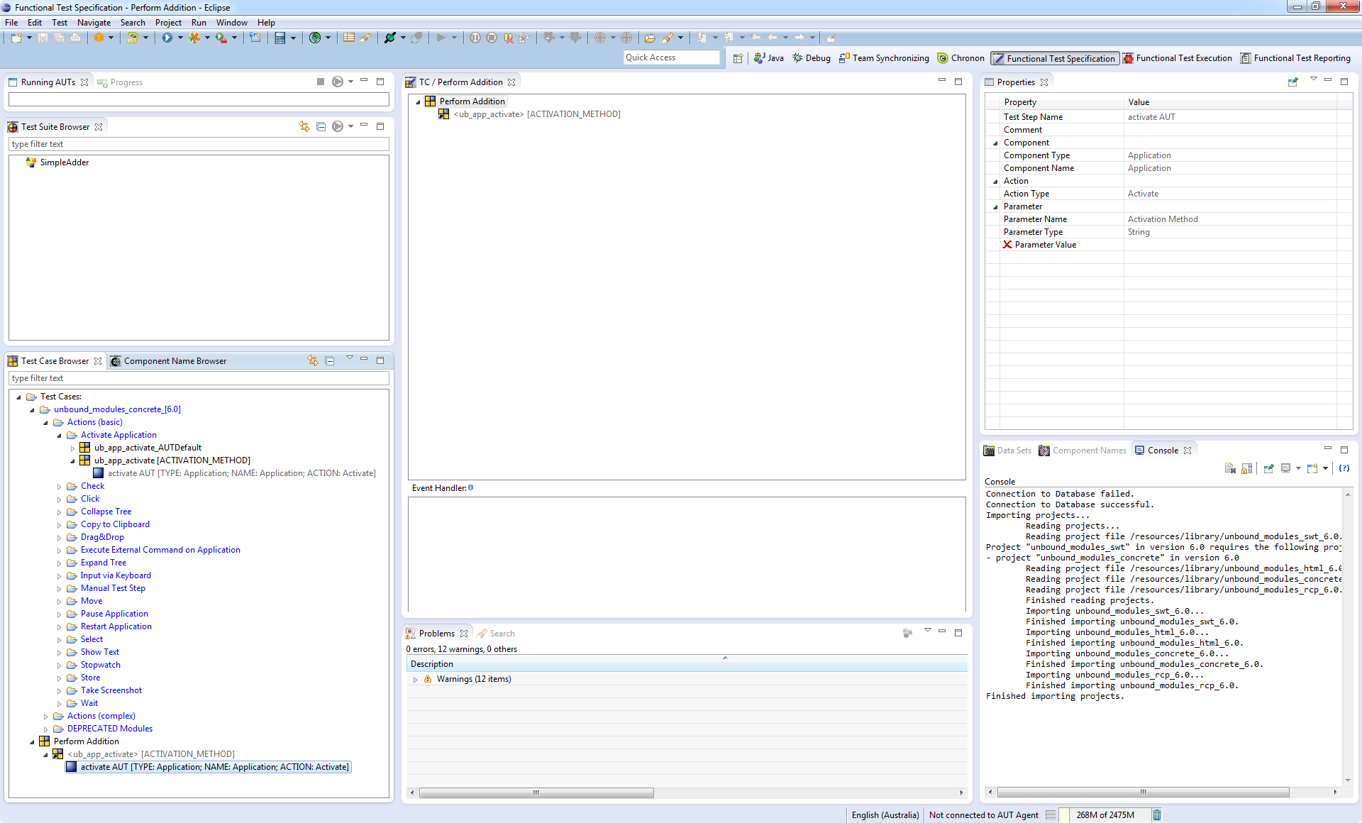

After adding the test case to a test suite, the test case, test suite, etc. are flagged with "Test Data for this node is incomplete". See the error markings on Screen2.png
Prior to dropping the database and starting again, I'd gone through the complete cheat sheet and got the same problem. Same scenario as what I originally posted when using the embedded database.
Note that I haven't actually gotten a complete end-to-end config done with the plugin version. What I did get going was configuring using the standalone version then openning the project database with plugin version and making a minor change. Perhaps it is the action of initially adding the test case to the test suite that causes the problem with the plugin version?
Also note that the test steps related to activation in the unbound_modules_concrete_[6.0] library are now flagged as being in error whereas other steps in the library are not. This changed to become an error only after adding the test case to the test suite.
