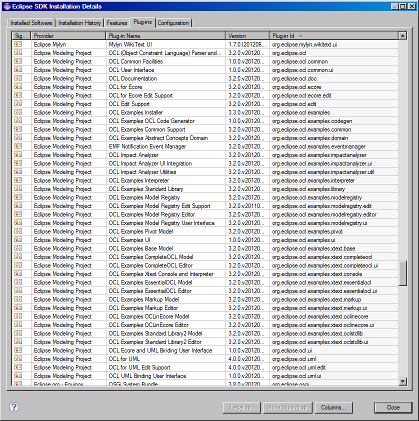

  • Attachment: cjjbagbi.png
    (Size: 94.44KB, Downloaded 322 times)

i have added all OCL related plugin(shown in screen shot) but still when i try to add View in Perspective extension then i am unable to find "org.eclipse.ocl.examples.interpreter" or "org.eclipse.ocl.examples.xtext.console" view.
Currently i am using Indigo. Are you referring to JUNO?
thanks

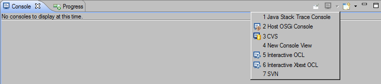

You are looking for a View. You should be looking at the 'Open
Console' menu in the Console View.<br>
<br>

  • Attachment: cbhfgiab.png
    (Size: 8.56KB, Downloaded 301 times)
