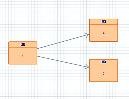

- When expanded some extra nodes will be added/shown in adiagram editor. For example in the attached figure, when "expand" on "X" node is clicked, then nodes "A", "B" and links X->A, X->B will be shown. The case will be opposite on collapse.
index.php/fa/10807/0/
The following is execute method of my custom feature class. The question is how can I add/delete nodes and links to the diagram from the "execute" method of my custom feature class?

I assume that you already have an add feature for your Task nodes.
Hence you can simply add these lines to the execute method of your custom feature:
AreaContext areaContext = new AreaContext();
areaContext.setLocation(20, 20);
areaContext.setSize(100, 100);
AddContext addContext = new AddContext(areaContext, <your business object>); // Tasks or Links
addContext.setTargetContainer(getDiagram());
getFeatureProvider().addIfPossible(addContext);
