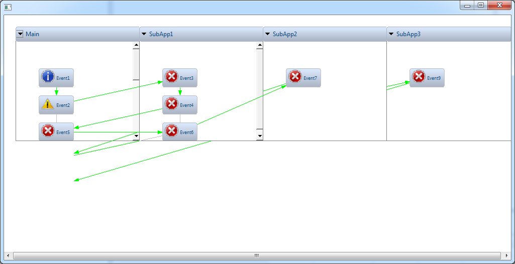

I'm having a problem with resizing of nested GraphContainer nodes.
In the example I'm having I have a graph containing four GraphContainer components A,B,C and D.
index.php/fa/10799/0/
These containers contains a different numbers of nodes. However it doesn't seem to be resizing properly. This can be seen on the picture.
If I then for instance call "A.setSize(1000,1000);" the nodes inside this container is just resized, such that I still have the same space issue.
How can I get the GraphContainer size bigger, while maintaining the same size for nodes inside this container?
Help is very much appreciated.
Thanks in advance.

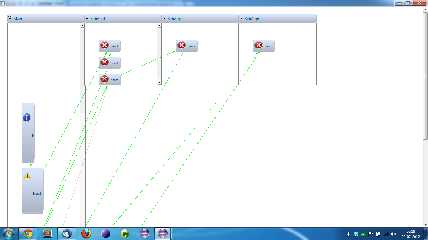

I have tried to do this, however it's only for some reason the x-axis which is reacting to this.
For instance I tried to call setSize(50,50) on the first node, in the "Main" subgraph.
The result can be seen below.
Any other ideas?
otherwise I will try to look into rewriting the GraphContainer, fullfilling my needs.
Thanks in advance.
