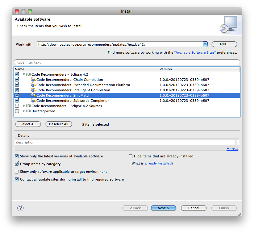

The installation works for me using these selections:
index.php/fa/10811/0/
Could you check if above selection settings would work for you? If not, I assume it's a mirror issue that needs a little more work but can be fixed. Please let me know if the installation works with the above settings.

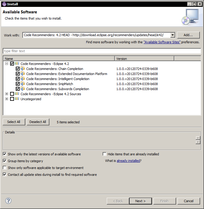

Is the checkbox "contact all update sites during install to find required software" checked?
Re: Problems updating from HEAD Updatesite [message #897422 is a reply to message #897419] Tue, 24 July 2012 01:07 Go to previous messageGo to next message
Yes, i have checked it every time.

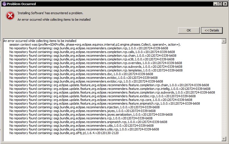

index.php/fa/10815/0/
and these installations ends with:
index.php/fa/10816/0/
