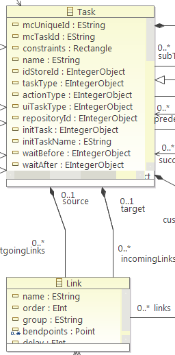

Problem Description:
My EMF based domain model (partial) is here .
I have Task nodes and tasks are connected by Links, sounds simple!!
I can create Tasks nodes and show them on Graphiti editor programatically but the problem is in creating links between tasks.
In the following code (within a command that will be executed from some context menu in UI - eclipse RCP), I am trying to create two Task nodes, and a Link to connect these two tasks.
