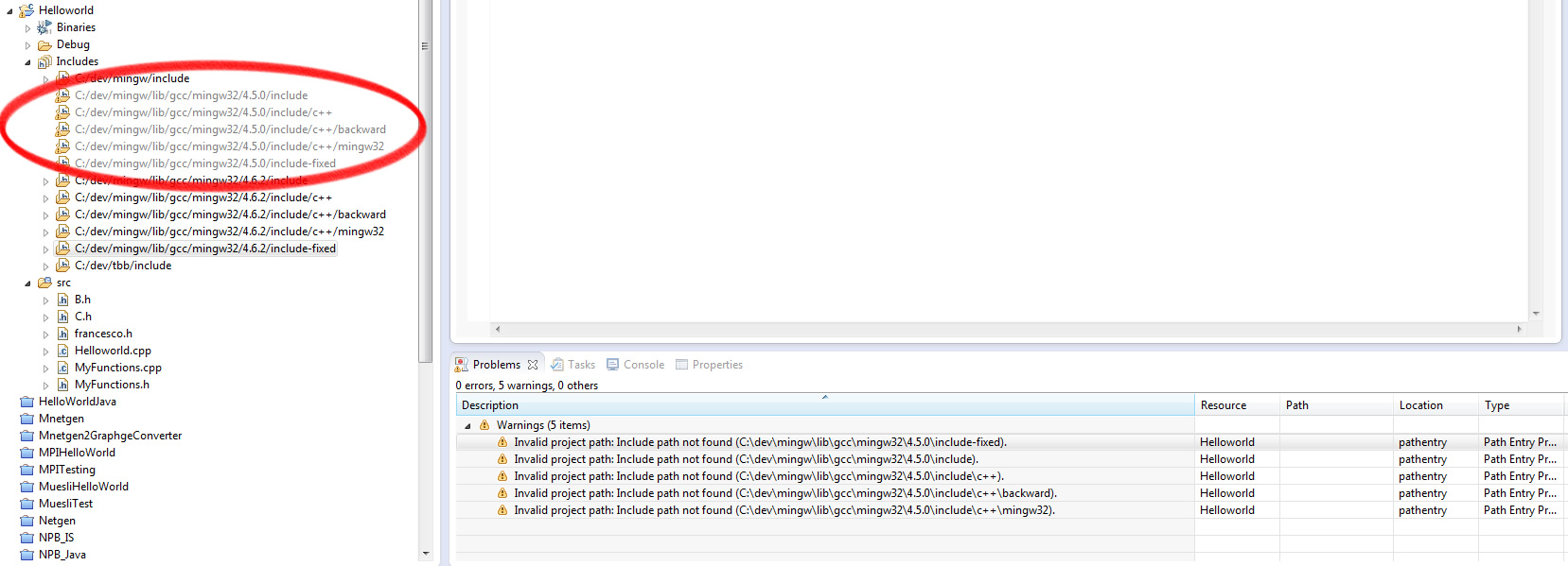

I recently updated both Eclipse to CDT 8.1 and MinGW GCC. Doing that, I deleted the old files of the previous GCC installation. Eclipse recognised the new version of GCC but it also keeps in the old projects the inclusion directories of the previous GCC version, as showed in the screenshot. Is there some way to fix that?

Re: Updating the compiler [message #896862 is a reply to message #896823] Fri, 20 July 2012 03:47 Go to previous messageGo to next message
Project Properties->C/C++ build->Discovery options
click the button "Clear discovered entries" (might be necessary for C and C++ and different build_configs)
Re: Updating the compiler [message #897058 is a reply to message #896862] Sat, 21 July 2012 05:32 Go to previous messageGo to next message
thank you Axel, it did work.
- Mickey
