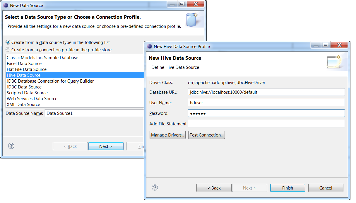

Re: Hive and Birt [message #897029 is a reply to message #896874] Fri, 20 July 2012 16:34 Go to previous messageGo to next message
I just tested this with those jars and the latest hadoop/hive servers
and it worked for me. I then replaced all the jars in the manage
drivers button with the ones attached in the screenshot and it worked as
well. This was with hadoop 1.0.3 and hive .90 . I assume you have the
thrift server running on your cluster?
Jason

Re: Hive and Birt [message #897040 is a reply to message #897037] Fri, 20 July 2012 18:11 Go to previous messageGo to next message
Dabe,
The original list of jars was for the hadoop .20 release. I just
updated today to test it out on my ubuntu machine. Probably the
simplest way to get it running is to collect the jars I posted (Will
depend on your version). Browse to the plugins directory of your birt
install. Locate the jdbc plugin/drivers directory. Mine is here:
C:\birt\eclipse-reporting-juno-win32\eclipse\plugins\org.eclipse.birt.report.data.oda.jdbc_4.2.0.v20120611\drivers
Copy the list of jars to this folder.
Startup the BIRT designer and create a new BIRT Report Project. Then
create a new BIRT report. Add a data source. Make sure to use the Hive
data source (see attached shot). Put in the right ip for the node
running hive server and test the connection.
BTW what os are you running the designer on. Are you using CDH or
Apache Hadoop and what os are you running on?
Jason

> possible!
> (but the thing is, i tried with hadoop 1.0.3 and hive 0.8 but Hive told
> me that Hadoop had to be in version 0.20.x with x>1, but maybe they
> changed this with hive 0.9!)
> And yes I launched the Hive server with : hive --service hiveserver.
> Can you give me precise instructions about your settings, because maybe
> there is something I did wrong, because I never really found clear
> instructions or tutorial, just the page from the birt site, and the
> instructions are not so detailled! Especially the hive part, is there
> something special to do on Hive?
> Thanks!
  • Attachment: newhive.png
    (Size: 98.20KB, Downloaded 443 times)
Re: Hive and Birt [message #897076 is a reply to message #897040] Sat, 21 July 2012 09:20 Go to previous messageGo to next message
Hello Jason,
I updated my Hadoop and Hive setup, now I am on 1.0.3 and 0.9.0. I am running everything (hadoop, birt, hive) on MAC OSX Lion, and not through Cloudera.
I added the exact same jars as you, I did exactly what you said but nothing works, what happens when you test the connection? What IP adress do you enter? I use localhost as I am running local, no?
Now when I click on test connection, it makes birt crash. When I don't test the connection, i click ok, then I add a new data set with the hive data source I just created, then I click next and then it tells me that the connection took to long (timeout error)...
I really don't know where the problem is. I have one hadoop cluster, with one datanode, hive is working fine, i launched the thrift server, but nothing works...maybe it's birt that is not working? Or maybe i should use CDH?
[Updated on: Sat, 21 July 2012 09:21] by Moderator
Re: Hive and Birt [message #897227 is a reply to message #897076] Mon, 23 July 2012 05:41 Go to previous messageGo to next message
It works!! Finally I managed to get it running!
The problem was that I launched the hive server with hive working. I mean, on the terminal, I had Hive launched, i did queries, etc, and then I launched the terminal. This time I just launched the hive server and it worked! So it was a silly thing that prevented everything from working. The only thing I want to add is that configuring the hive birt connector isnt really explained anywhere...but now it worked for me Smile
THanks again Jason for your time!
Re: Hive and Birt [message #897399 is a reply to message #897227] Mon, 23 July 2012 21:31 Go to previous message
If you are using the hive default embedded db I believe this only allows
one connection. That might have been the issue.
Jason
On 7/23/2012 5:41 AM, Dabe Elie wrote:
> It works!! Finally I managed to get it running! The problem was that I
> explained anywhere...but now it worked for me :)
