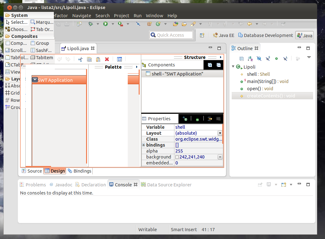

I've downloaded under ubuntu 12.04 (64bit) the newest Eclipse Juno 4.2 and then I've installed all packages connected with windowbuilder 4.2 (from "install new software" window). Everything is working fine until I click "design" tab in SWT project (class for applicationWindow). The problem is palette is totally misplaced and docked on the top left corner of eclipse. What can cause a problem? Earlier I've had Indigo and everything was warking fine (everything with windowbuilder, I had problems with another plugins so I've switched to Juno).
I'm new to eclipse and java itself, maybe I've missed something obvious for regular user of eclipse.
I've tried:
- reinstalling windowbuilder
- windowbuilder version for indigo (3.7)
- linux shell (unity with compiz and unity 2d without compiz)
- palette is misplaced also on Swing project
* it looks the same in any combination
I've found two links
https://bugs.eclipse.org/bugs/show_bug.cgi?id=385103 (just started)
https://bugs.eclipse.org/bugs/show_bug.cgi?id=368543 (tips don't work)

This is a known Eclipse issue. Whether it is an Eclipse bug or a Linux bug, I don't know. It definitely is not a WindowBuilder bug. All I can do is point you to all of the different ideas suggested in Eclipse Bug 368543. Several of those ideas have worked for other folks running into the same issue.
