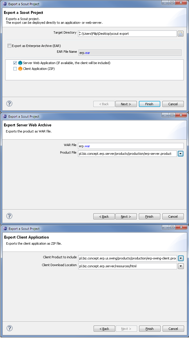

And the best would be a screenshot of every page in the export wizard. To answer the following questions:
- I've attached them to this post
Does the export path contain any special characters?
- No, the path is ok - the empty scout project exports just fine to that path.
Which product are you trying to export?
- /pl.biz.concept.erp.server/products/production/erp-server.product
attached
Which client product is included in the export?
- Swing or none - does not matter. Swing client alone exports just fine. Server alone fails.
Do you export also a RAP server?
- No, I have currently no rap target installed.
Are you trying to export a war or an ear file?
- Currently WAR, but ear fails in the same way.
