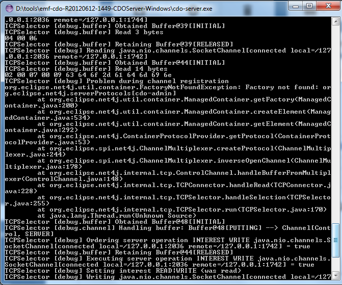

I downloaded the pre-built package for windows and just ran it.
Then I connected through the CDO Sessions view from Eclipse 4.
When I connect I get FactoryNotFoundException (see the attached image).index.php/fa/10659/0/
Is that normal?

By the way the exception is thrown again and again every few seconds.

Am 11.07.2012 10:55, schrieb Federico Tomassetti:
Hmm, that's kind of odd, but in no way hindering evaluation. If, on the client-side, you close the CDO Administration
view it should go away (fix1). You can also fix it by manually deploying the org.eclipse.emf.cdo.server.admin bundle to
the server (fix2).
The reason for this behaviour is that the new CDO Administration view periodically tries to establish a cdo-admin
protocol connection to all configured servers and list their repositories. This bug describes the new CDOAdmin API:
381472: Design a repository administration API
https://bugs.eclipse.org/bugs/show_bug.cgi?id=381472
These types form the client-side API:
/org.eclipse.emf.cdo.admin/src/org/eclipse/emf/cdo/admin/CDOAdminClient.java
/org.eclipse.emf.cdo.admin/src/org/eclipse/emf/cdo/admin/CDOAdminClientManager.java
/org.eclipse.emf.cdo.admin/src/org/eclipse/emf/cdo/admin/CDOAdminClientRepository.java
/org.eclipse.emf.cdo.admin/src/org/eclipse/emf/cdo/admin/CDOAdminClientUtil.java
Can you please submit a bugzilla so that I can fix the your current problem in the next maintenance build (fix1)?
Cheers
/Eike

Am 11.07.2012 16:53, schrieb Eike Stepper:
Sorry, I meant fix2 ;-)
