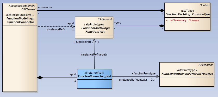

I have to deal with a very complex link mapping. I wanted to know if it is possible with GMF without touching the generated code:
- A FunctionType has several Ports
- A FunctionType can have a FunctionConnector
- The FunctionConnector connects two ports
(see attached image)
But in my case, I have a intermediate class "FunctionConnector_port". So my linkmapping can't directly reference FunctionPort. Instead the linkmapping has to use the intermediate class "FunctionConnector_port", and from FunctionConnector_port I can reference the desired port.
Is the FunctionConnector link mapping possible with GMF ?!
  • Attachment: link.png
    (Size: 36.33KB, Downloaded 200 times)

Re: complex link mapping [message #894698 is a reply to message #894614] Tue, 10 July 2012 04:00 Go to previous message
do you have an example how the concrete syntax shall look like?
