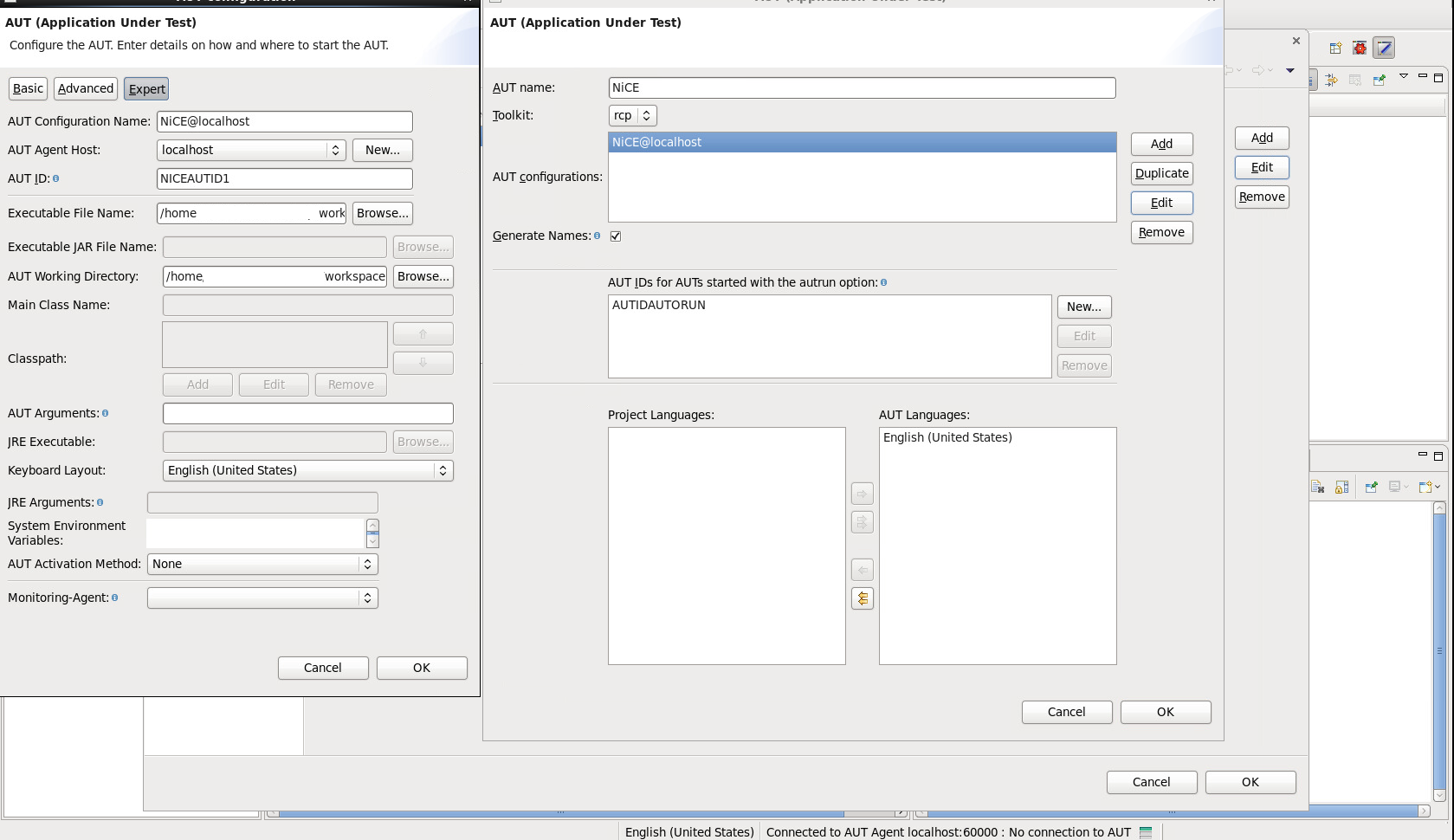

You could post what parameters you are using for testexec and a screenshot of your AUT configuration (the full dialog, expanded up until "Expert" settings). That may help.
Alex
Re: Tests pass in ITE, but fail in testexec: Unsupported Language [message #895338 is a reply to message #894599] Thu, 12 July 2012 09:49 Go to previous messageGo to next message
Sure.
Attached is a picture of my configuration.
testexec below:
./testexec -server "localhost" -port 60000 -project "SharingNiCETests" -autid AUTIDAUTORUN -testsuite "ProfileTester" -dbsceme "jubulaHudsonTests" -datadir /home/......./jubulaData -resultdir /home/......./jubulaResults -language "en_US" -dbuser "user" -dbpw "" -data "/home/....../jubulaWorkSpace" -version 1.0
I had to edit some lines out, but the "......" represents a legal set of subdirectories.
I am using a MySQL database, however I have tried the tests this with the embedded H2 and run into the same issue.
Re: Tests pass in ITE, but fail in testexec: Unsupported Language [message #895525 is a reply to message #895338] Fri, 13 July 2012 07:39 Go to previous messageGo to next message
Ah, I believe I have the culprit Smile
When you run the test via testexec, you're starting the AUT via autrun, not via a configuration (as you appear to when you start the test via the ITE). As autrun replaces the configuration, they can be (and are, in this case) configured differently. Generally you only need to use autrun if you are working with Test Jobs - perhaps you could be using a configuration for the testexec instead. More information on different ways of starting AUTs is here.
That's not to say that you can't / shouldn't connect via autrun, it just took me longer to realize the problem Wink - when you start an RCP AUT via autrun, you also need the parameter for the keyboard layout, described in the documentation here. I guess if it's not entered, some kind of default is used. If you specify that parameter, then it should work.
