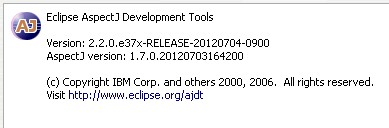

I'm able to reproduce Bug-290741 (not sure it's the same bug) with eclipse 3.7.2 and AJDT 2.2.0
AJDT Info
AJDT version: 2.2.0.e37x-RELEASE-20120704-0900
AspectJ Compiler version: 1.7.0
usingVisualiser=true
usingXref=true
usingCUprovider=true
org.aspectj.ajdt.core.compiler.weaver.verbose = true
org.eclipse.ajdt.internal.ui.tracing.checked.filters = set: Compiler,Compiler /
Progress messages,Compiler / Task list messages,Builder,Builder / Classpath,Parser,Model Sanity Check
ajde.version.at.previous.startup = 2.2.0.e37x-RELEASE-20120704-0900
Encoding of Java sources are being determined from content-type: UTF-8
I even tried to force UTF-8 through non-standard compiler options but I had no success with -encoding UTF-8 or -encoding utf8 either.
Am I missing anything? Thanks so much! Please excuse any inconvenience.
