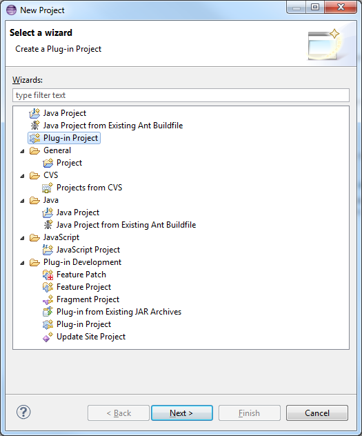

I just did a fresh install on Windows 7 and have the same issue.
OS: Windows 7 Home Premium SP1, 64 bit
Juno 4.2.0 (build id: I20120608-1400)
Install directory: C:\eclipse
PDP 3.0.0.v201201110400-77-184_2BEICRgM_fMVcz0M4Va9O (from Indigo)
Hardware: Samsung, i5-2450M
JRE: 64 bit, JRE7, installed in C:\Program Files\Java\jre7
I try to open a new project via File -> New -> Project, but there is no option to create a PHP project
