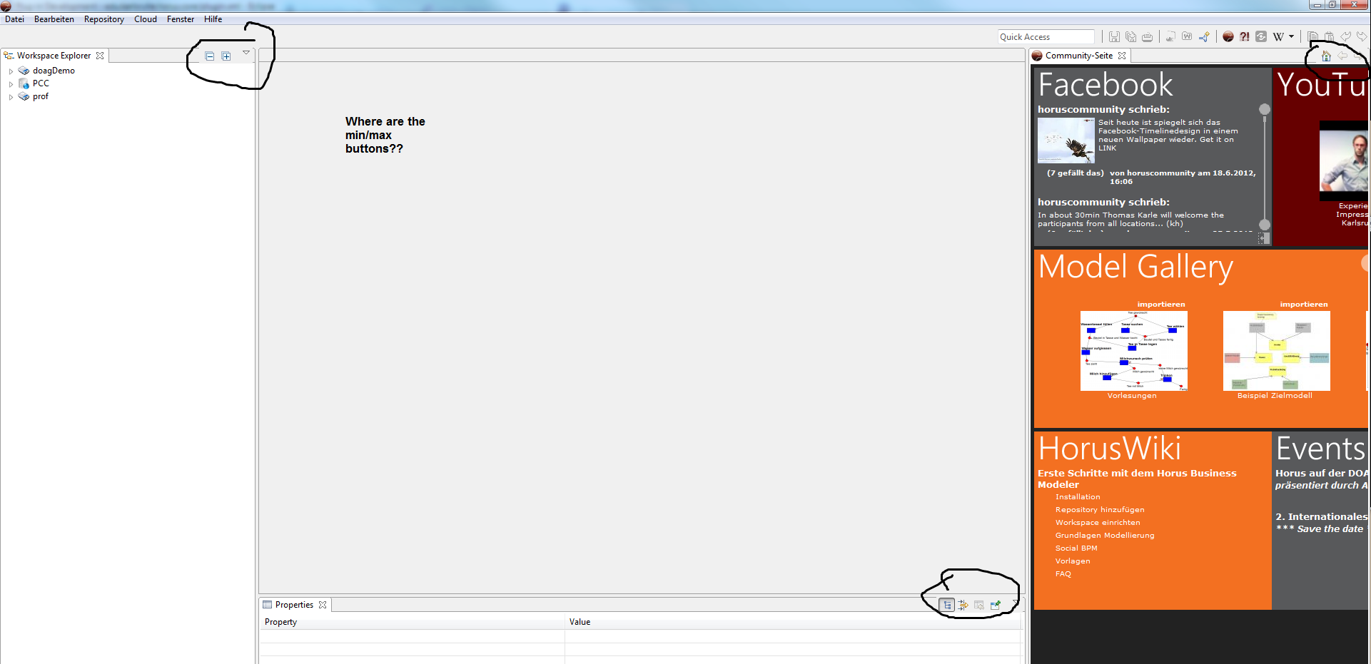

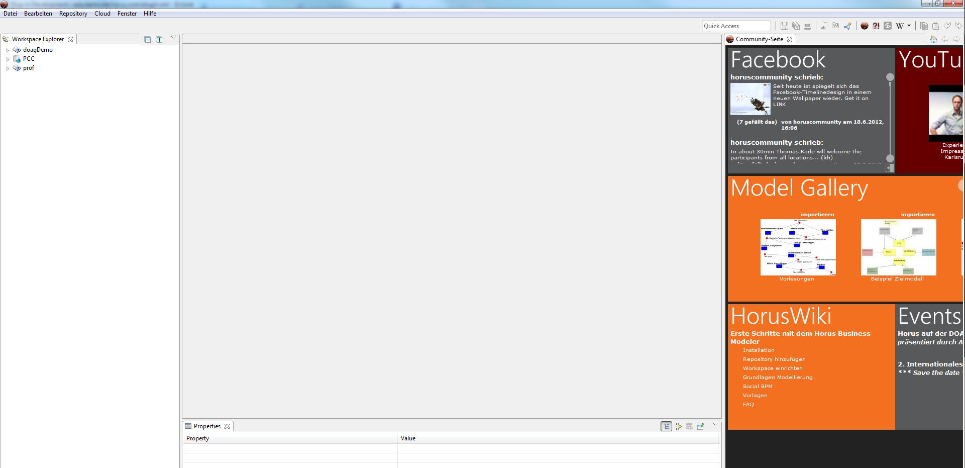

Unfortunately, we're facing the same problem when trying to fire up our eclipse 3.7 based RCP-App from within eclipse 4.2. Furthermore there is some "empty space" before any toolbar-entries start.
And last but not least: We've an intro-site that popped up full-screen with eclipse 3.7. It is now shown as you can see in the attached image. Furthermore when closing the intro/welcome-page, the space on the right hand is not "recycled" and is that way wasted during all time.

You can see not designed "Quick access" in both of this applications: Quick access + additional not designed toolbar.
When I open my Eclipse RCP application in 4.2 I see same not designed toolbar (see attachment).
Please help remove this elements.
