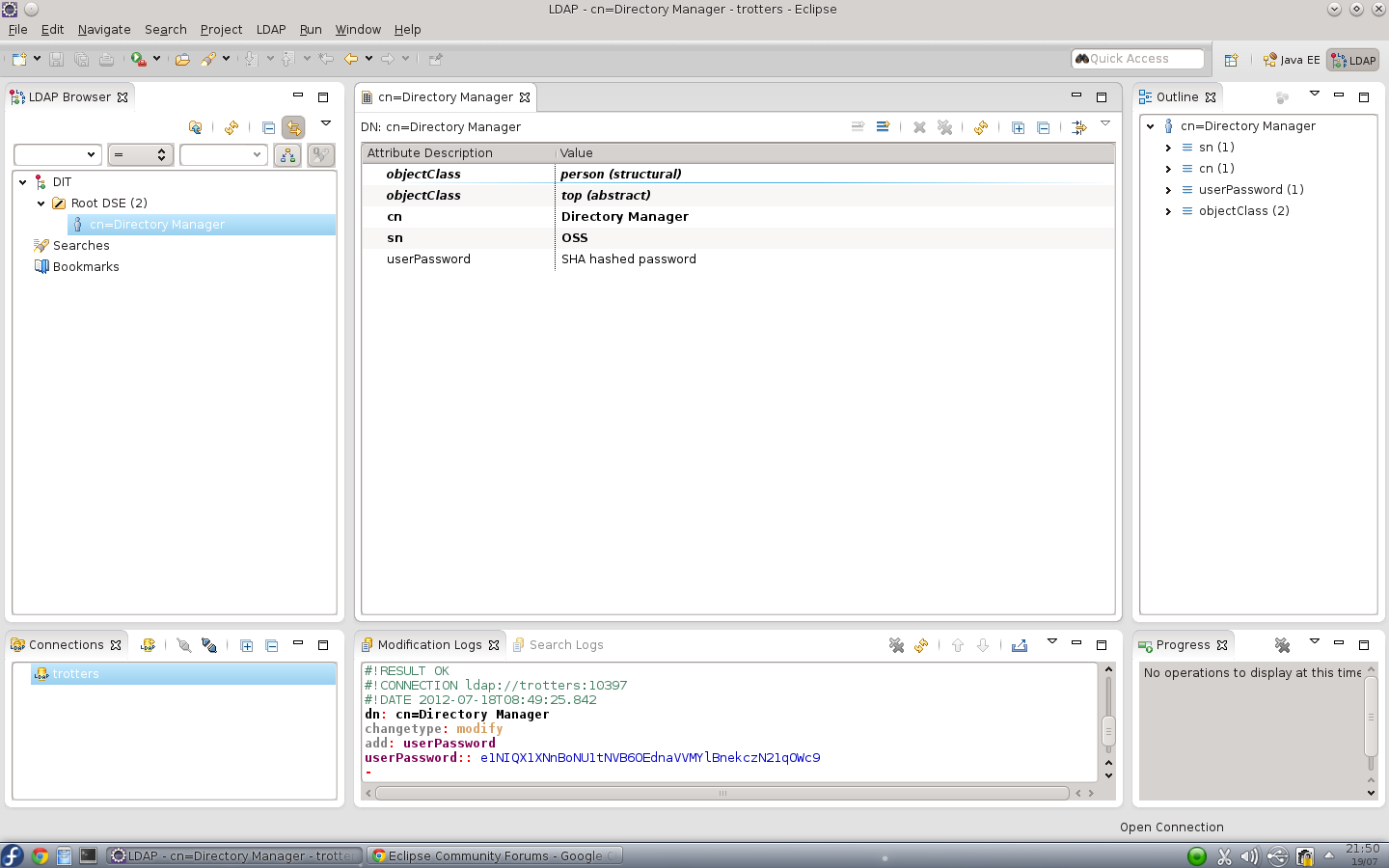

Re: Wrong font on Eclipse Juno Editor Tabs [message #896801 is a reply to message #893722] Thu, 19 July 2012 16:56 Go to previous messageGo to next message
Did anyone even test the Juno release on KDE? It looks absolutely terrible. What's with all of the white backgrounds and the stupid toolbar shading?
  • Attachment: snapshot1.png
    (Size: 119.95KB, Downloaded 385 times)
Re: Wrong font on Eclipse Juno Editor Tabs [message #896811 is a reply to message #896801] Thu, 19 July 2012 17:46 Go to previous messageGo to next message
Switch to the classic theme if you don't like the new one.
Tom
