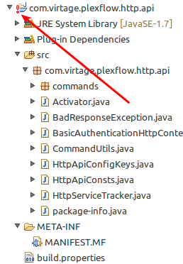

Hi all,
from time to time I encounter red exclamation on icon of PDE project
like in attachment but can find out what's (and where) wrong because all
source files, manifests, everything are without any problem.
However, for example when running tests, I'm notified that there are
errors in my projects but didn't tell me what errors....
Thanks for any help!
Libor

It usually indicates a build path problem. Go to properties-java build path and check if there is something wrong there, like unbound libraries etc.

Unfortunately I'm still not able to find out what's wrong. In build path
in Properties doesn't report any problem. Are they some other ways, please?
Libor

Hello Libor Jelínek,
Sopot Cela is right, usually the red exclamationmark indicates that there is something wrong with your dependencies.
Maybe you should look into your run configuration and validate plugins, and look for problems.
Sometimes the TargetPlatform contains the some jar/bundles in a differend version so that it ends in a conflict.
So check your dependencies in your Manifest, check the buildpath and your TargetPlatform.
Simon
Re: Red exclamation in PDE project icon [message #890917 is a reply to message #890877] Sat, 23 June 2012 08:30 Go to previous message
See the Problems view or Markers view. It should be there somewhere.
