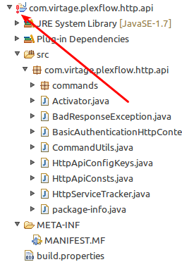

Hi all,
from time to time I encounter red exclamation on icon of PDE project
like in attachment but can find out what's (and where) wrong because all
source files, manifests, everything are without any problem.
However, for example when running tests, I'm notified that there are
errors in my projects but didn't tell me what errors....
Thanks for any help!
Libor

Dude, it's probably your projects' build path. Right-click on the project and then go to Java Build Path. Look at each tab (Source, Projects, Libraries, Order and Export), and you will probably find your problem. Here are a few issues it might be:
- Referencing a project that has errors.
- A JRE library being reference is not bound.
- A source folder doesn't exist.
Also, occasionally you might run into issues with the Order and Exports; however, this doesn't usually give you error until runtime.

Could also be "Cycle" problems.
