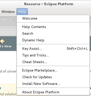

Checked and Marketplace Client appears
index.php/fa/10371/0/

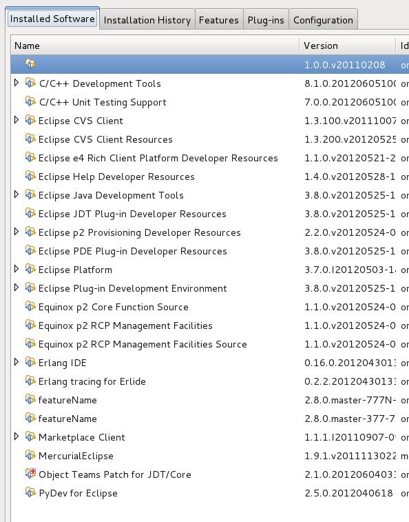

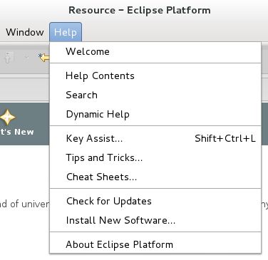

Next I chose to install "Eclipse Java Development Tools" and...
index.php/fa/10372/0/
Note - no Marketplace
Anyone able to offer some insight on how to get the Marketplace Client back on the menu???

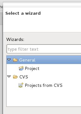

Added C++ Development Tools... MercurialEclipse... and the Erlang IDE (with appropriate restarts, of course)...
Went to create a new project:
index.php/fa/10374/0/ versus index.php/fa/10375/0/
Note no Java, no C++, no Mercurial, no Erlang, for that matter basically a whole "lotta" nothing.
