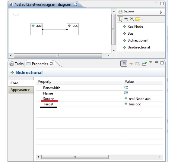

as in the picture u can see two nodes have a connection between them.
node1 is aaa and node2 is ccc.
now if i select the transition line u can see the properties like bandwidth, name, source,target.
in source u can see is written real Node zzz. here aaa is node name and real Node in type of the node. same for target.
I want that source only shows the name aaa not the type.
so source should be aaa and target should be ccc only.

Hi iqbal Mising name,
This seems to be more of a GMF question than Epsilon related. However, I
think (but am not sure) you will find that the text shown in the
properties is based on what the toString method of the respective model
objects returns.
Steffen
