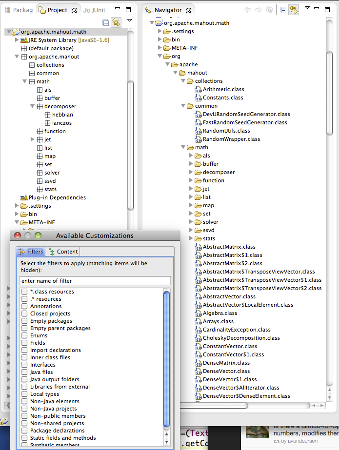

I'm not yet sure if it's a bug or some misunderstanding on my end.
I created a new plug-in project from an existing jar. Problem: Classes in this jar are properly imported (as can be seen in the navigator view) but cannot be referenced nor do they show up in the Project/Package Explorer (all filters disabled as shown on the screenshot). Do I miss something obvious?

Can you check if the classes are inside a source folder OR in other
words they are on the build path or not ?

Right. .classpath contained '/' as src path. Then this was a misunderstanding on my end. Although I'm not sure why the wizard generates these entries as they don't make sense to me. Anyways, thanks.
<classpath>
<classpathentry kind="con" path="org.eclipse.jdt.launching.JRE_CONTAINER/org.eclipse.jdt.internal.debug.ui.launcher.StandardVMType/JavaSE-1.6"/>
<classpathentry kind="con" path="org.eclipse.pde.core.requiredPlugins"/>
<classpathentry kind="src" path=""/>
<classpathentry kind="output" path="bin"/>
</classpath>
