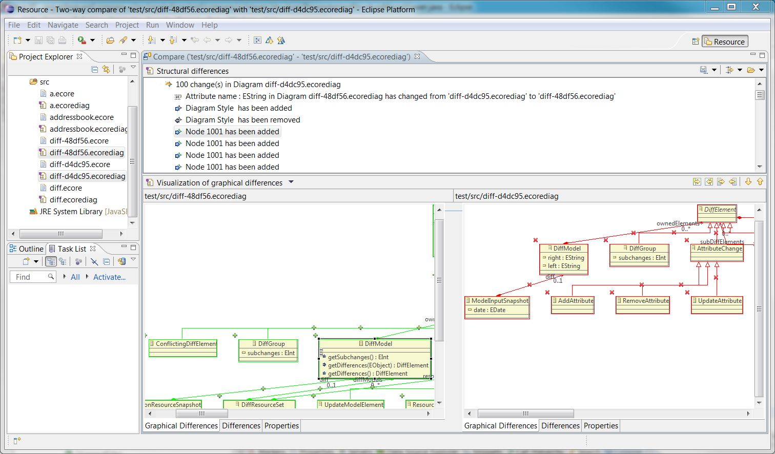

I am run EMF compare on different versions of diff.ecorediag. The
"graphical differences compare" seems strange. I just get a list
Node 1001 has been added
Is there another version of EMF compare that gives more specific names
rather than Node 1001?
The diffing algorithm does not seem to be able to make the comparisons
between versions correctly. For one version it says everything is
deleted and the new version everything is added.

Re: [EMF Compare] Graphical Representation [message #886916 is a reply to message #886910] Fri, 15 June 2012 16:37 Go to previous messageGo to next message
I am in Eclipse Indigo 3.7 RC2.
I install EMF Compare version 1.3 from the update site.
Then I install the latest version of EMF and EMF tools from Indigo -
download. eclipse. org/releases/indigo
After that is all installed from update sites. I compare two versions diff.ecorediag from the EMF compare GIT repo. So I highlight the two files and right click and select compare with each other. I either get a blank gray screen or the node 1001 repeated many times. Attached is the image of what I get.
  • Attachment: Capture.JPG
    (Size: 209.12KB, Downloaded 344 times)
