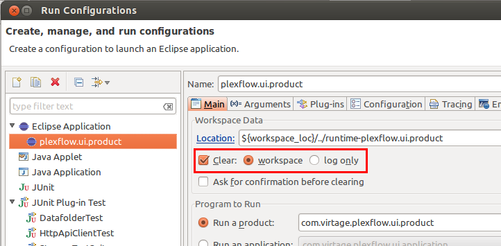

Re: Help with RCP from existing .jars [message #887837 is a reply to message #886350] Sun, 17 June 2012 04:11 Go to previous message
Try to clear run configuration workspace before. Easiest by checking
"Clear workspace" in Run Configuration (Run / Run Configurations...).
Libor
