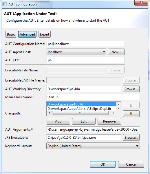

Re: Advanced Settings for AUT [message #884968 is a reply to message #884961] Tue, 12 June 2012 03:33 Go to previous messageGo to next message
Hi Alex,
I did update the AUT on seeing the link earlier also.
Have attached a screenshot of the same.
In the ClassPath field, I have defined all the variables which come under "-Djava.library.path"
The remaining values I have defined as AUT Arguments.
and also set the JRE executable.
In my Client log this is the error message I am getting:
2012-06-12 15:51:25.191 [Connection.ReaderThread:Socket[addr=localhost/127.0.0.1,port=60000,localport=61694]] ERROR o.e.j.c.c.c.StartAUTServerStateCommand - AUTServer could not start: Error while starting AUT!
Any ideas?
  • Attachment: aut.png
    (Size: 44.68KB, Downloaded 319 times)
Re: Advanced Settings for AUT [message #884981 is a reply to message #884968] Tue, 12 June 2012 04:02 Go to previous messageGo to next message
The first thing I notice is that you have neither entered a jar or an executable to start the AUT. One of these two fields must be filled in to tell Jubula which AUT you want to start.
HTH,
Alex
Re: Advanced Settings for AUT [message #884989 is a reply to message #884981] Tue, 12 June 2012 04:24 Go to previous messageGo to next message
Hi Alex,
But that is because both the fields were disabled.
The Startup class is the launching class.
since i entered that value in the Main CLass Name field, the Executable File Name and the Executable Jar File Name got disabled.

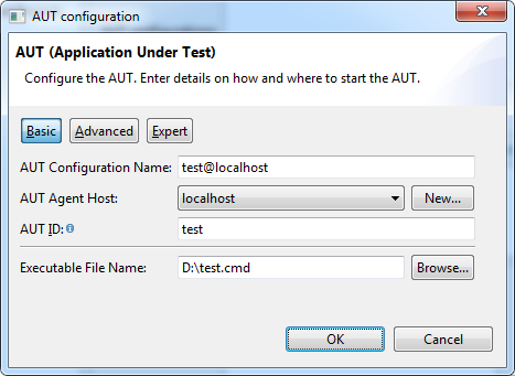

Re: Advanced Settings for AUT [message #885033 is a reply to message #884958] Tue, 12 June 2012 06:01 Go to previous messageGo to next message
Put the command and its parameters in a .cmd file. Check if this starts your application. If it does, put the path and filename of the .cmd in the executable field of the AUT configuration. Now your AUT should start.
Achim
Re: Advanced Settings for AUT [message #885982 is a reply to message #885033] Wed, 13 June 2012 21:24 Go to previous messageGo to next message
Hi Alex,
I am able to start the application when I save the command and the parameters as a .cmd file in the command prompt.
However, I am getting the same error when I try to start the application through Jubula.
I have attached a screenshot of the application settings.
I am setting the value in the "Basic Setting" and not changing anything else.
Please guide me.
  • Attachment: test.png
    (Size: 28.88KB, Downloaded 330 times)
Re: Advanced Settings for AUT [message #885984 is a reply to message #885033] Wed, 13 June 2012 21:31 Go to previous message
Ok I got it working!
I had given the wrong application type.
Thanks a lot for your suggestions.
I really appreciate it.
