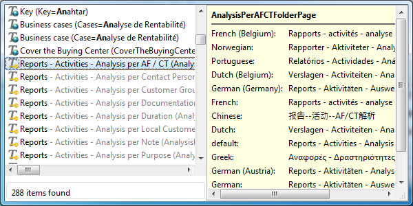

Sort order should be non-case-sensitive -- it is currently very hard to find short lowercase texts.
index.php/fa/12537/0/

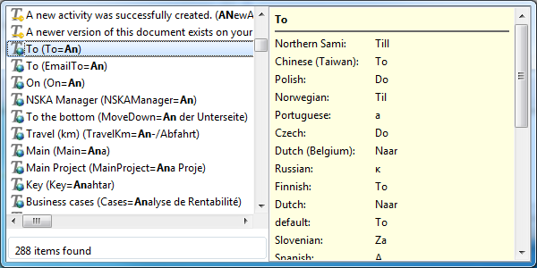

There seems to be special logic connected to a '-' character. Any text following a '-' is grayed out. Probably not intended...
index.php/fa/12538/0/

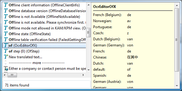

Searching for short foreign texts which are a common prefix for many texts is hard. This is not an issue for me as I rarely search for foreign texts anyways.
It turns out that this is not a real issue when searching for keys, because for short texts, the key is usually the same as the text in the development language.
Generally, searching for keys works quite well because of the fact that keys cannot contain spaces. As soon as typing a multi-word key, other text entries are quickly eliminated because of the missing spaces in the key.
So I really like the partition into two groups with the development language in the upper group. I think that the new implementation is a great improvement over the current behavior! Thank you!
