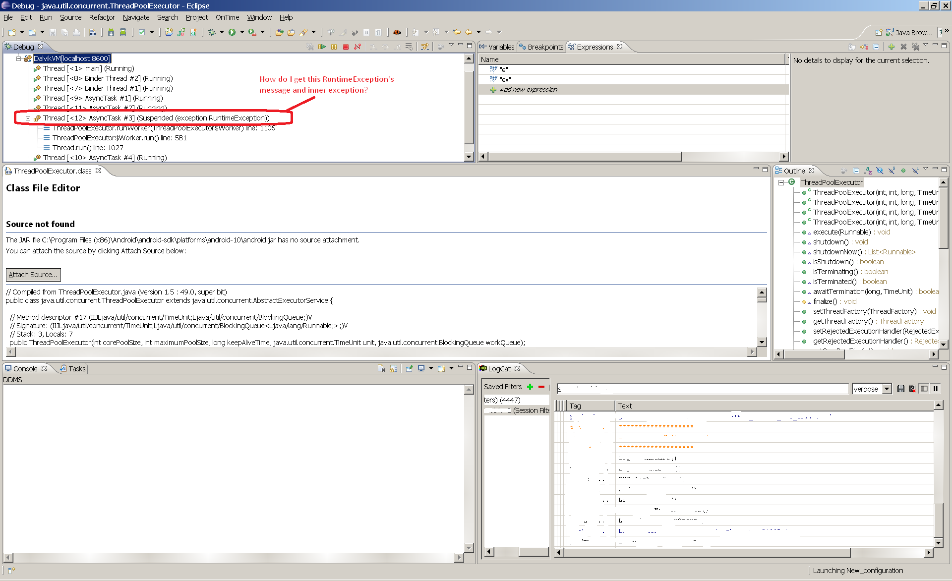

Hey, I have a problem which has vexed me for many days. It goes something like this:
I tell Eclipse to break on all uncaught exceptions, which it does do.
I run my code in debug mode.
Eclipse breaks on a RuntimeException, but the code it breaks on is not my code, and I do not have the source. I cannot step through, view, or watch any expressions in the code surrounding the place the exception is thrown at.
The debug window shows "Thread X is suspended (RuntimeException)", but I cannot view the exception (I can't see the message, the callstack trace, any inner exceptions, etc.) I would like to see these things, but I can't find any way of doing it. Right-clicking into the debug window doesn't give me anything useful, and hovering over any of the text in the window doesn't do anything either.
Anyone know how to place a watch on the exception object or at least view its message?
I'm attaching a screenshot of what I'm talking about.
PS.
I know about the special breakpoint for exceptions. Using it doesn't seem to change much. Breaking on the exception isn't the problem; trying to do anything useful with it afterwards is.
index.php/fa/9828/0/
  • Attachment: problem.png
    (Size: 128.46KB, Downloaded 2757 times)

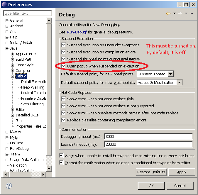

The following preference should help you:
Java > Debug > Open popup when suspend on exception
When you hit an exception breakpoint a popup with the exception object comes up.
You may want to push it to the Expression view (Ctrl-Shift-I), so you can better drill into the exception object.
I typically enable this option only temporarily, because I don't like to always get the popup thrown in my face Smile
but it seems to be the best available solution for your problem.

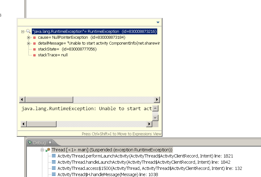

For future people searching, this is the solution in picture form:
index.php/fa/9837/0/
Once the option "Open popup when suspended on exception" in Window->Preferences->Java->Debug is turned on, you can left-click on the exception in the Debug window and a popup will display (much like mousing over on a variable name during debug stepping) with Exception details:
index.php/fa/9838/0/
  • Attachment: scr1.png
    (Size: 37.90KB, Downloaded 2597 times)
  • Attachment: scr2.png
    (Size: 24.88KB, Downloaded 2579 times)
