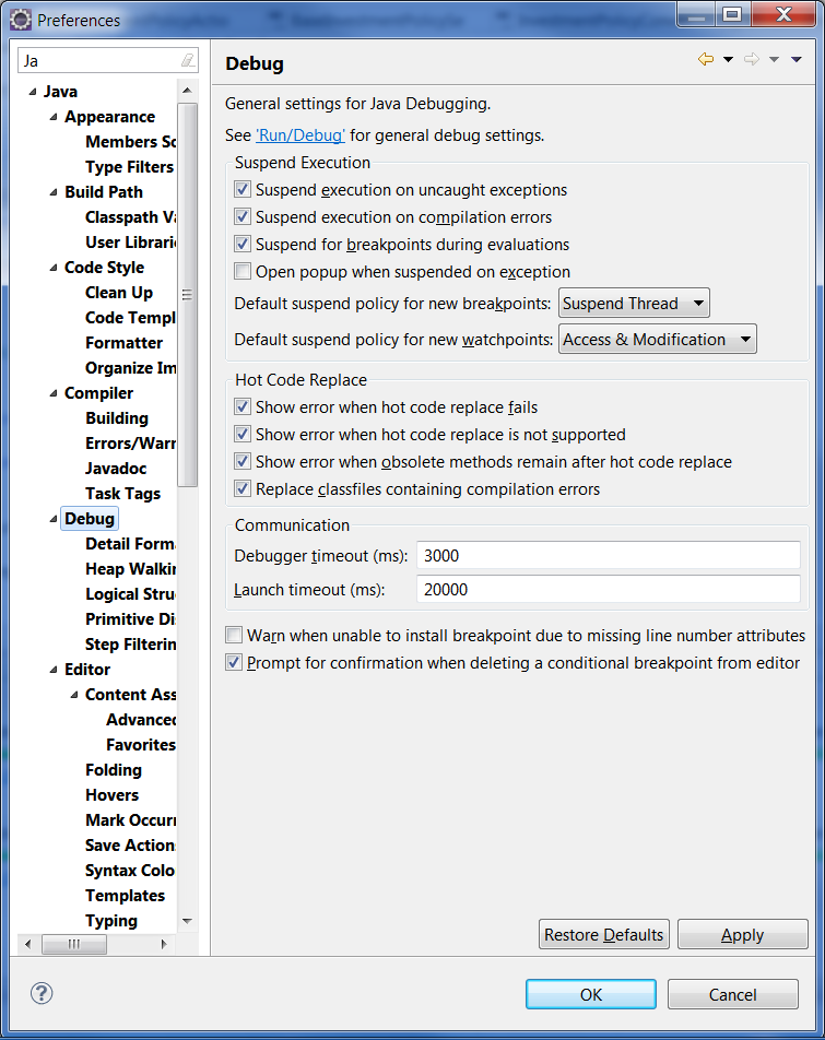

This is exactly what experiencing. Thank you.
All four checkboxs under "Hot Code Replace" are checked.
Is this OK?
