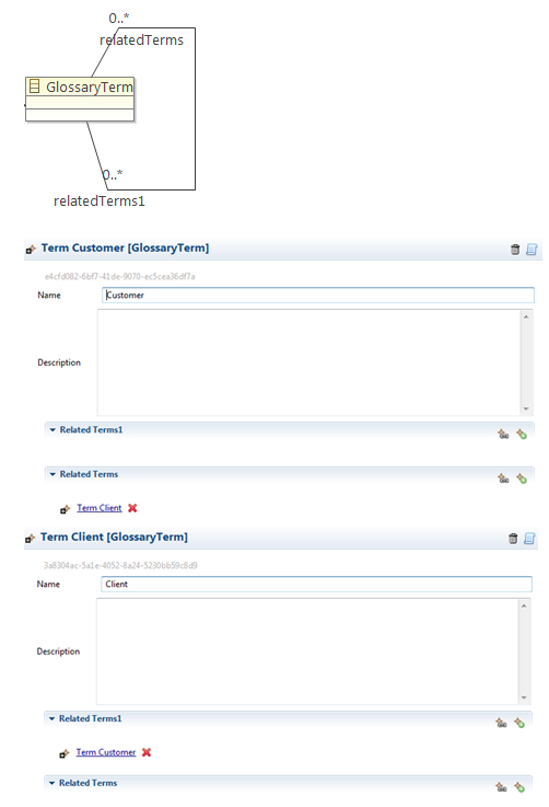

my idea is the following: I would like to manage different terms within a glossary. The terms can be related to each other. For example, I want to create a Term 'Customer' that is related to 'Client'. In my (ECP) frontend I would like to show all related terms to 'Customer' (which is 'Client') but also all related terms to 'Client' (which is 'Customer').
Therefore, I have the following metamodel (extract):
GlossaryTerm
attribute: name : EString
reference: relatedTerms : GlossaryTerms (opposite:relatedTerms1)
reference: relatedTerms1 : GlossaryTerms (opposite:relatedTerms)
The frontend works as specified, I can see 'Client' as 'relatedTerm' when opening 'Customer'; and I can see 'Customer' as 'relatedTerm1' when opening 'Client'.
But, I would like to see just one attribte 'relatedTerms'. How to solve this in EMF/ECP with EMF standards (maybe derived attributes?). An alternative solution will be writing a custom widget.
To illustrate my question, I attached a screenshot of the front-end and the metamodel.
Thanks in advance,
Chris

Hi Chris,
the way to go would be to create a custom widget. A derived attribut
would not work, as it would not be editable. As we already had this
requirement in the past, I am considering to create a general mechnism
for this kind of reference in the EMF Client Platform. Could you create
a BR for this?
Jonas

Hi Jonas,
thanks for your answer. I opened a bug:
bugs.eclipse.org/bugs/show_bug.cgi?id=380242
Best,
Chris
