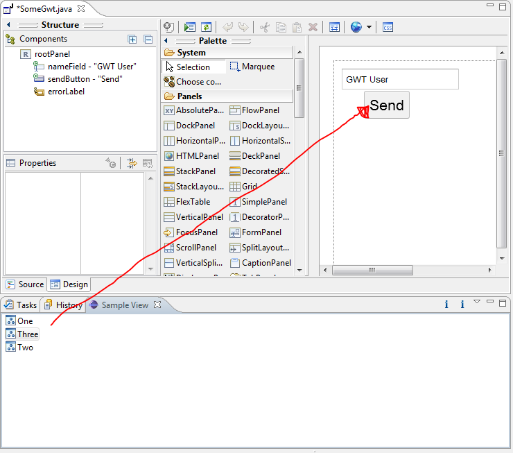

I'd like to extend the GWT window builder editor so that i can drop custom items from another eclipse view into the widget designer.
I already tried to reach my goal by contributing to org.eclipse.ui.dropActions. This extensionPoint would exactly do what I need. But the window builder seems no to support PluginTransfer drop actions.
So far I could not find a way to get notifications on WB drop events. Is there an extension point which i couldn't find where it is possible to register for drop events?
In my case i wan't to enable dropping of my custom items from another view and then get notficiations when an item was dropped on a WB widget.
