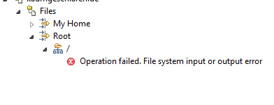

Hi everybody,
as you figured i'm a very beginner and currently stuck at a small issue.
I'm trying to remote access my ftp server using "TM and RSE 3.1.1" from
download.eclipse org/dsdp/tm/updates/3.0
and get the following error when i try to access it:
"Operation Failed. File system input or output error."
I have the exact same eclipse version with this plugin on my other PC and it works just fine. The only difference is, on this machine i additionally have a SVN software installed for eclipse.
i'm using eclipse indigo on windows 7.
If you need anything else (logs or something) let me know.
Thanks in advance for your help.
Best regards
Sumit
