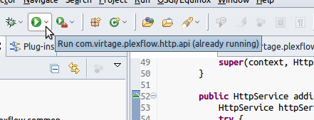

when I run two or more times my app using OSGi Framework run configuration, I also lost a change to interact with and stop already running frameworks.
For example if I'm using HttpService in bundle running in already active framework, second try give me a error
!ENTRY org.eclipse.equinox.http 4 0 2012-05-18 18:44:45.727
!MESSAGE Port 8080 is use
!STACK 0
java.net.BindException: Address already in use
But I don't have any change to stop first framework. However Eclipse IDE knows about it and reporting it on Run toolbar button tooltip:
index.php/fa/9770/0/
But how do I stop (or open console to close) this already running framework? So far I'm shutting down whole Eclipse to kill this running Equinox.

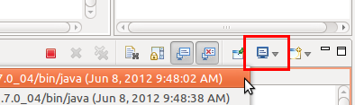

If you started with the "-console" option then open the "Console" view
and select the console of the running application and enter "close" in
the view as command. You may also use the "terminate" button in that
view but that's a hard termination which does not trigger a proper shutdown.

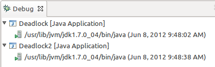

The other option is to switch to the "Debug" perspective and select the
running application in the "Debug" view. This will give you a "terminat"
button as well. Again, the terminate does not trigger a proper shutdown.

it doesn't sound to me like the same issue which I had... In my case it
was all about my Eclipse IDE UI user education because I didn't know
that Console view has a toolbar combobox to switch among running
processes. Or that I can see them from Debug perspective.
Libor
