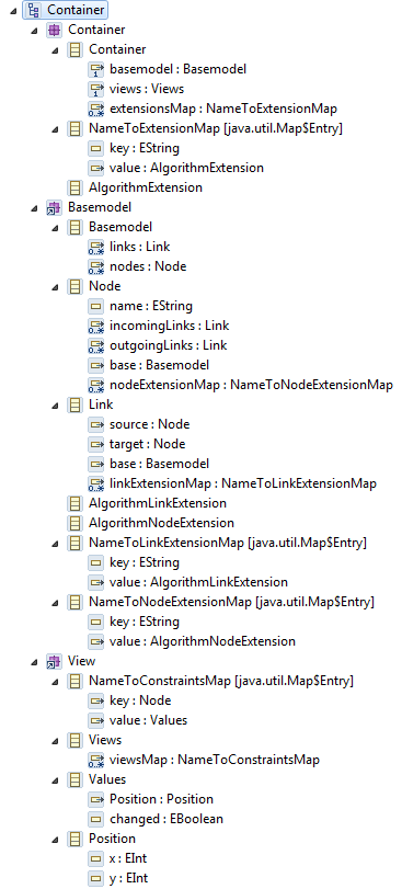

My resource is from type XMIResourceImpl and I don't get any EObject from getAllContents.
The given TreeIterator is empty.
I think there must be at least the container in there.
It seems that I have missed something, haven't I?
I have added the content type identfier, delete the model plugin.xml and regenerated the model code.
The same I have done for the editor and edit source code.
I attached the model structure for better comprehension.

Re: Get namespaces used in xml file [message #874296 is a reply to message #874016] Sun, 20 May 2012 08:39 Go to previous messageGo to next message
I don't want to annoy you, but I can't figure out the solution and I want to know what I am doing wrong. I am very grateful for your patience and advices.
I am really new to EMF and use the book EMF - Eclipse Modeling Framework, but such a specific case isn't covered by that book.
>> No, getContents returns an object from ContainerImpl.
> Then I'd expect the getAllContents iterator to iterate at least over that...
The ContainerImpl is a class generated out of my model and doesn't provide that method.
> I'm sure that if there is a root object, the iterator will yield at
> least that one as well as all the contained objects under it. So I
> think you have all the answers you need.
Yeah sure, but where is it?
The ContainerImpl is in general the root element, but doesn't provide the methods I need.
I hope attaching my models and genmodels helps to get more advices.
Perhaps there is a modeling issue.
Looking through the genmodel I noticed, that there is a fileextnsion property,
but it seems that it makes no difference.
The newest xml file looks like following:
<container:Container xmi:version="2.0" xmlns:xmi="hXXp://www.omg.org/XMI" xmlns:xsi="hXXp://www.w3.org/2001/XMLSchema-instance" xmlns:bellmanford="de.tit09.fms.algos.model.bellmanford" xmlns:container="de.tit09.fms.algos.model.container" xmlns:dijkstra="de.tit09.fms.algos.model.dijkstra">
Now each namespace is correctly displayed compared to my start post.

Re: Get namespaces used in xml file [message #874333 is a reply to message #874296] Sun, 20 May 2012 11:30 Go to previous messageGo to next message
Comments below.
It's Resource.getAllContents. Each EObject also has eAllContents. It's
an iterator. You use it in a for loop. In both cases, it walks all the
contained objects...

Re: Get namespaces used in xml file [message #874336 is a reply to message #874333] Sun, 20 May 2012 11:43 Go to previous messageGo to next message
Resource.getAllContents returns an object of the ContainerImpl.
ContainerImpl.eAllContents returns nothing.
> Container.eClass().getEPackage().getNsURI gives you the namespace of the
> root object. You need to traverse the other objects if you want to know
> all the namespaces.
Alright that is possible, but first I need the other objects. Smile
Or do you mean, that I shall go recursive through my objects with eContents()?

Re: Get namespaces used in xml file [message #874605 is a reply to message #874336] Mon, 21 May 2012 04:30 Go to previous messageGo to next message
Comments below.
Yes, the root objects of the resource.
So your container doesn't actually contain (via containment references)
at this point.
>> all the namespaces.
> Alright that is possible, but first I need the other objects. :)
Object's referenced by non-containment might result in namespace
declarations as well, if their xsi:type or xmi:type is needed in the
serialization (which is the case if the referencing feature's type is
abstract and the object is of some derived type). You can determine all
the object referenced via non-containment with
EObject.eCrossReferences(). So for each EObject you visit in
Resource.getAllContents() you can also visit that object's eCrossReferences.

So finally I got the getAllContents working.
It was a mistake in understanding the syso output in eclipse.
Because the output was [] I thought the iterator is empty, after more investigation
with the help of the debugger in eclipse I see that there are elements in the iterator.
>> But I found now a big issue with the Content Type Identifier in my case.
>> If I open a model file and I don't have all ecore models loaded in
>> example
>> the plugin isn't available.
> Yes, all models must be registered. In an Eclipse environment that
> won't be a problem because they're registered in their plugin.xml and
> those registrations will be globally available.
It is possible that not all model plugins are available, because it should
be an extensible application, where others can provide new model parts or plugins.
That is the reason, why I have a own genmodel for each model, see the attached model.zip
(hXXp://www.eclipse.org/forums/index.php/fa/9794/).
>> That means the * entry isn't at the first position.
>> Manual ordering of the entries for example with a LinkedHashMap isn't
>> possible.
>> A working way is to clear the ContentTypeToFactoryMap and only add the
>> * entry.
>> But I can't believe that the solution is a good one.
> There must be details you're leaving out. You can't register more than
> one factory for the same extension; you'll see problems about that in
> the error log. And for content types, it's their content type
> identifier that's registered. All resources with the content type's
> extension will be analyzed to see if they content your content type's
> type of content.
There are no errors in the log, otherwise I would react on them.
I have removed all file extensions expect for the container model.
But the problem with the PackageNotFoundException still remains.
I can't fix it with the following code:
Resource.Factory.Registry.INSTANCE.getContentTypeToFactoryMap().put("*", new EcoreResourceFactoryImpl() {
	public Resource createResource(URI uri) {
		XMIResourceImpl resource = (XMIResourceImpl) super.createResource(uri);
		resource.getDefaultLoadOptions().put(XMLResource.OPTION_RECORD_UNKNOWN_FEATURE, Boolean.TRUE);
		return resource;
My workaround is to clear that list and only add the * entry.
But it doesn't seem correct.
Looking in the keyset of the content types shows that all plugins,
which are available, and additional the * entry is shown.
Basically my idea is to provide a model, which can be simple extended by
other people and they can share their work in own plugins.
That is the reason why I can't be sure that all plugins are always
available.
> In the Generator you can do this via the GenPackage property for
> "Content Type Identifier". You'd set it to something like the qualified
> package name, e.g., org.example.library
What does the package name mean?
Must it be the plugin id or the Ns Uri of my model?
Which file extension shall be used for the contained models, which are
holded by the main container model?
[Updated on: Mon, 21 May 2012 09:13] by Moderator
