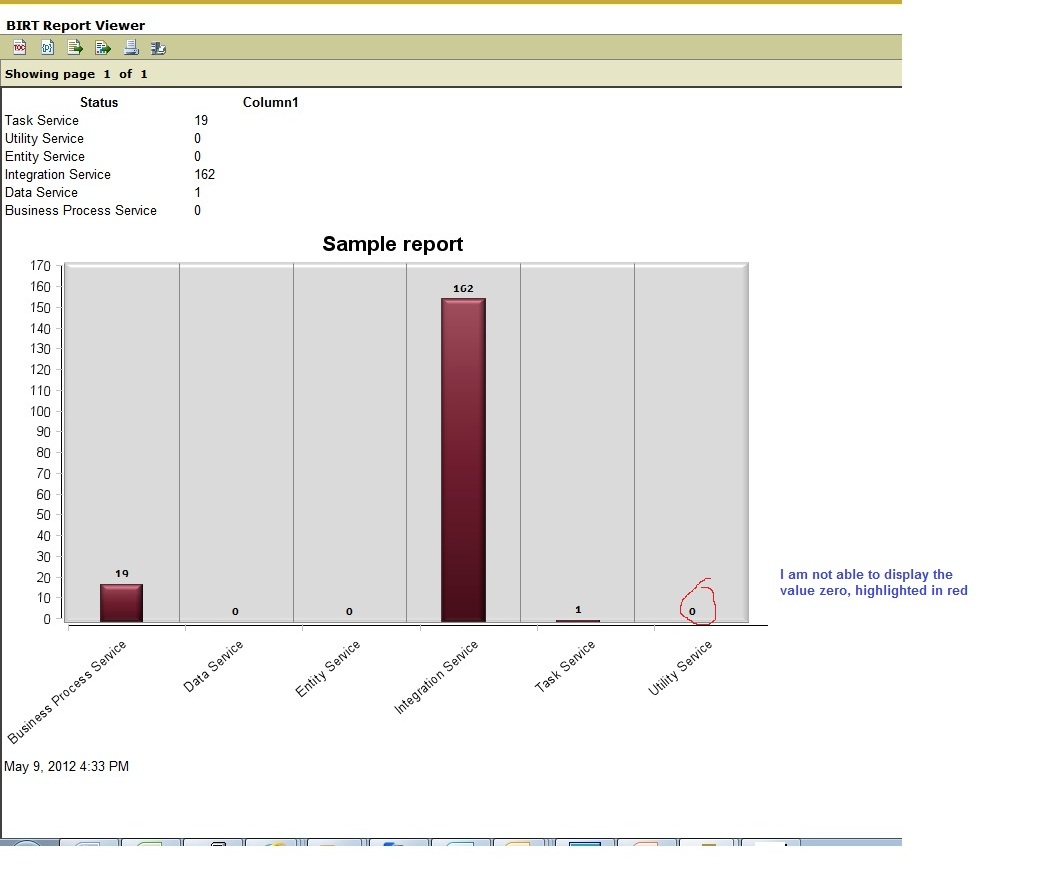

How to display zero value in the bar chart value series.
Attached the sample file and report design.

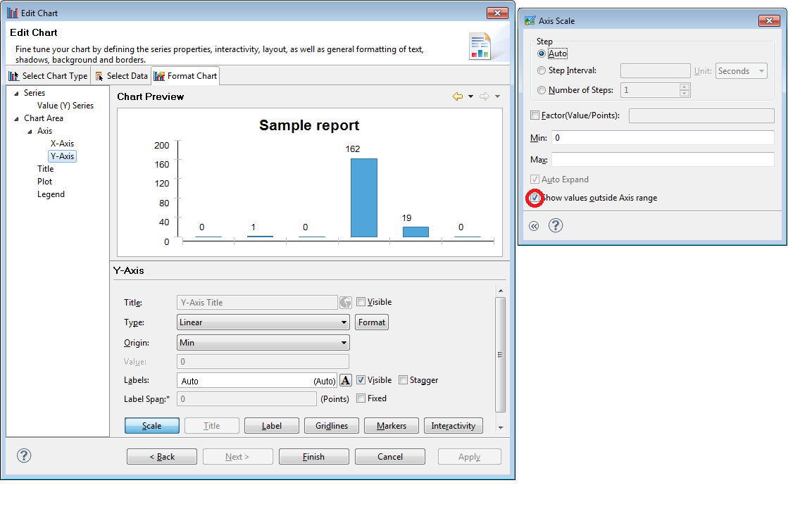

Re: How to display zero value [message #871056 is a reply to message #870854] Thu, 10 May 2012 12:56 Go to previous messageGo to next message
Select the y-axis scale on the third tab of the chart wizard. Enter 0
as a minimum value and check the show values outside axis range check
box. See attached screenshot.
Jason

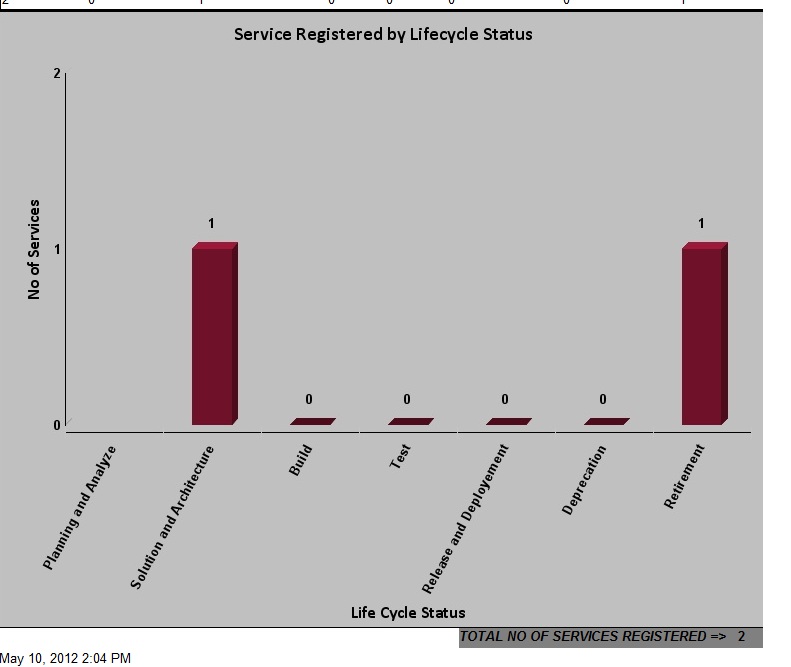

Re: How to display zero value [message #871107 is a reply to message #871062] Thu, 10 May 2012 17:12 Go to previous messageGo to next message
Hi Jason,
Thanks for the response. It worked for me. Here I am facing one problem in case of few reports, that is : " The fisrt bar is missing from the chart".
Please suggest. For ur ref here I am attaching screen capture.
Thanks in advance
AR
Re: How to display zero value [message #871251 is a reply to message #871107] Fri, 11 May 2012 12:08 Go to previous messageGo to next message
Is the value for Planning and Analyze a null? If so add this script to
the chart:
function afterDataSetFilled(series, dataSet, icsc)
var list = dataSet.getValues();
for ( i=0; i<list.length; i=i+1)
if ( list[i] == null )
list[i]= 0;
Jason

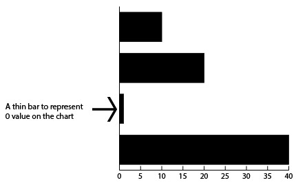

Re: How to display zero value [message #1693100 is a reply to message #871251] Tue, 21 April 2015 13:36 Go to previous messageGo to next message
I need the chart to change a value on X-axis if "0" to "1" , so that I can display a small width of the bar graph for 0 value instead of a blank column.
How do I achieve this? I will not be jeopardizing the data because another column will accurately display the actual value as text.
I am using BIRT RCP designer 4.4.2
Please see attachment for example.
Re: How to display zero value [message #1693295 is a reply to message #1693100] Wed, 22 April 2015 21:20 Go to previous messageGo to next message
You should be able to do just like the above code in the afterdatasetfilled method only changing 0 values to 1.

Re: How to display zero value [message #1693384 is a reply to message #1693295] Thu, 23 April 2015 11:48 Go to previous messageGo to next message
you mean
if ( list[i] == 0 )
list[i]= 1;
?? I tried this to no luck.
Re: How to display zero value [message #1693993 is a reply to message #1693384] Wed, 29 April 2015 17:10 Go to previous messageGo to next message
Actually that worked, thanks!!!
