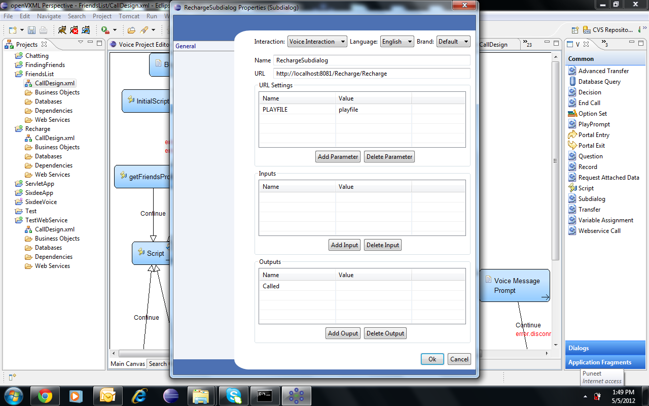

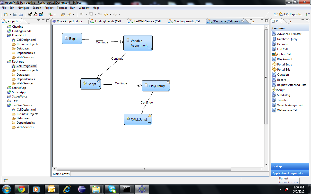

Thanks for your reply Randy. I am attaching you the screen shot of my subdialog configuration ,screen shot of call flow of my subdialog module and also the tomcat logs where you can find the VXML . I might have done some mistakes , as i am very new to this. Please help and guide me in this.

Vineet, it looks like you aren't trying to invoke a VXML subdialog, but
rather want to invoke the OpenVXML project "Recharge". With the version
of OpenVXML you're using, there are a couple of issues with this:
* Applications can't directly invoke other applications, but only
Application Fragments. Unfortunately, your project Recharge is an
Application, not an Application Fragment, and so you're going to need to
create this as a Fragment in order for this to work
* The subdialog module you're using is for invoking a static VXML
subdialog document (an entirely different thing -- this is a construct
specified by the VXML specification). To invoke an Application Fragment,
once it's created you'll find it in the Application Fragments list, in
the lower right-hand corner of your IDE -- just drag it onto your canvas.
I'd suggest you consider upgrading to the 4.0 codestream (there's
another recent message on this list which offers instructions on how to
do this) -- you'll find in the 4.0 codestream that what you're trying to
do will work just fine -- any application can invoke any other
application at well, with no restriction on how many layers deep this
can go (whereas what you're using now only lets Applications invoke
Application Fragments, so the depth of calls is firmly limited to 2).
There are upgraders built into 4.0 that will convert your projects over
the first time they're opened, but know that this is a one-way trip. If
you're going to do this, I'd strongly suggest making a copy of your work,
just in case.

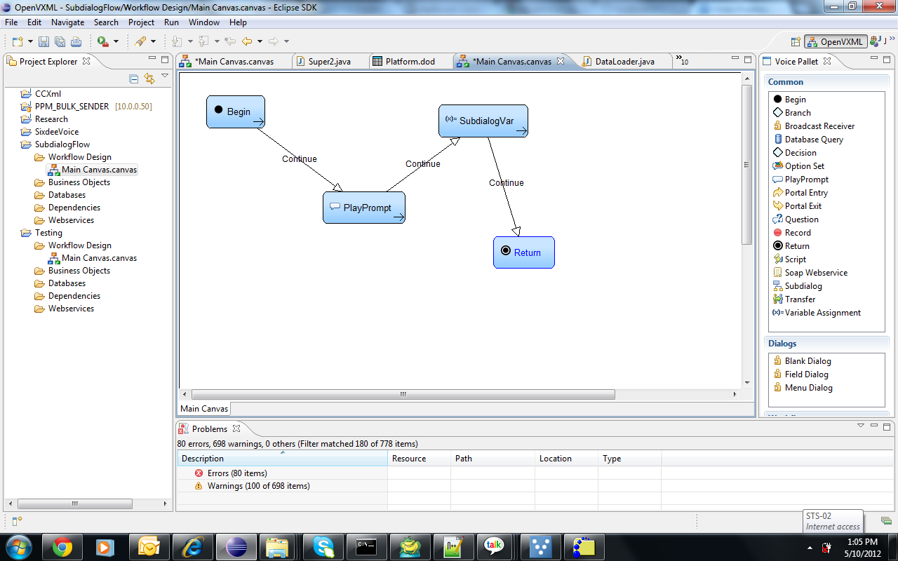

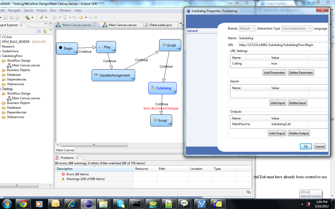

Now I am trying subdialog on 4.0 version, but still the same problem when i call different application I am not able to return back to my main call flow from subdialog Sad . I am ending the flow of my subdialog with return module but what I am expecting is not happening for me. For Testing I have created on main flow application (named as Testing) and from that calling subdialog application (names as SubdialogFlow). I am attaching the image of my subdialog configuration and main flow (MainFLow_subDialogConfig.png) , Subdialog application flow (subdialog.png) and the tomcat logs.
Please help me in finding the problem in this
Thanks Smile

You're still using the wrong dialog to invoke the application. The
dialog you're using is only for static VXML <subdialog> documents. You
need to add an instance of SubdialogFlow directly to your canvas and
replace the "Subdialog" block. You can either do this by right-clicking
on the canvas, and selecting SubdialogFlow from the list, or by closing
the Problems view at the bottom to reveal the rest of the Voice Pallet --
the very bottom of that is where the available applications are listed.
Aside from that, the rest of it looks pretty good.
