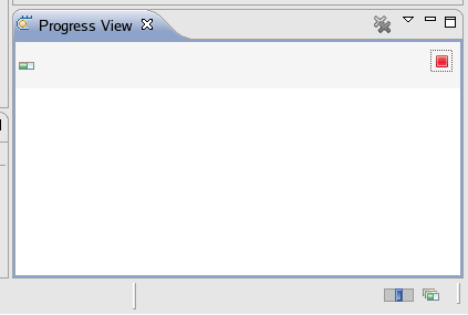

Re: Run job without reporting progress [message #869632 is a reply to message #869616] Thu, 03 May 2012 14:31 Go to previous messageGo to next message
Yes, I tried that, but it is shows activity/progress (see attachment).
reloadJob.setPriority(Job.DECORATE);
reloadJob.setUser(false);
reloadJob.schedule();

Re: Run job without reporting progress [message #869654 is a reply to message #869632] Thu, 03 May 2012 15:49 Go to previous message
Did you also try Job#setSystem(true)?
Ultimately it is up to the progress viewer implementation, which jobs to
show and how.
HTH
Rüdiger
