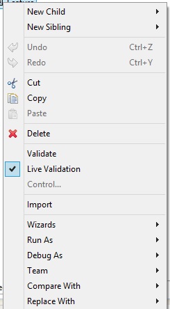

Due to Mikal hints, I was able to create my own menuContribution through the org.eclipse.ui.menus extension point as youc an see in the image (import is the one I added).
index.php/fa/15936/0/
I'm wondering now how I can place it on a different section (maybe before Validate). Using ?before/after=additions is the only one which works, so I reckon additions (like Wizards, Run as..) is contributed by Eclipse and the above (undo, cut, copy) is contributed by emf?
Edit: I've seen that you can call the super constructor of the generated ActionBarContributor with a style bit. org.eclipse.emf.edit.ui.action.EditingDomainActionBarContributor.menuAboutToShow(IMenuManager menuManager) seems to be the method where the order is determined. Is there a way to alter this and maybe remove additions?
Using ?after=redoAction for example didn't work which was wondering me.
