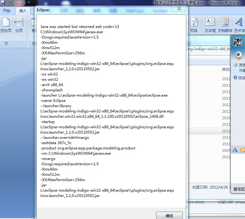

Re: about the using of OCLinEcore [message #857254 is a reply to message #856371] Thu, 26 April 2012 07:48 Go to previous messageGo to next message
Since you suggest me the Xtext OCL Console was introduced in Indigo. I downloaded the Indigo Modeling tools for win32 and win64. But for win32, when I tried to installed the modeling tools using the "Installing new software" menu, Eclipse showed an error information "An internal error occurred Comparison method violates its general contract", just a few words, which puzzled me. And I also tried the win64 and this time I even cannot restart the eclipse. The attachment is the screenshot for the error in the win64 edition.

I only have 32 bit Windows machine so I only use win32.
I presume that you should use whichever is appropriate to your machine;
so I would expect onle of the two to fail miseravly just as you observe.
When reporting problems that are not clear you must be more accurate;
you may know what "Indigo Modeling tools for win32 and win64" mean. I
don't I would need exact download file specifications.
You report "I tried to installed the modeling tools using the
contract", just a few words, which puzzled me."
In order to help, I need to know what menu actions you think were
appropriate and details of the error that you observe.
Ed Willink

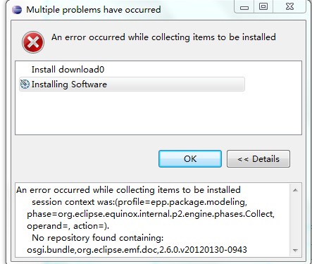

Re: about the using of OCLinEcore [message #860720 is a reply to message #857305] Sat, 28 April 2012 03:01 Go to previous messageGo to next message
I have updated the error information for details. Both the windonw-64 bit and windows 32-bit edition have the folloing errors when installing. The picture is in the attachment.

Hi<br>
<br>
The attached PNG contains only the start of the error message; there
is much more if you scroll the error window. So I cannot tell much
apart from seeing that you appear to be using Juno M5 or M6 and the
emf.doc is failing. Since EMF is a very basic install, clearly you
are doing something very wrong or unusual.<br>
<br>
In my previous message I wrote:<br>
<br>
<i>When reporting problems that are not clear you must be more
accurate; you may know what "Indigo Modeling tools for win32 and
win64" mean. I don't I would need exact download file
specifications.
</i><br>
<br>
<i>You report "I tried to installed the modeling tools using the
its general contract", just a few words, which puzzled me."
<br>
<br>
</i>
<i><br>
</i>
<br>
If you are not prepared to provide useable error reports, and ignore
the advice you are given, then you are wasting your time and mine.<br>
<br>
&nbsp;&nbsp;&nbsp; Regards<br>
<br>
&nbsp;&nbsp;&nbsp; &nbsp;&nbsp;&nbsp; Ed Willink<br>
