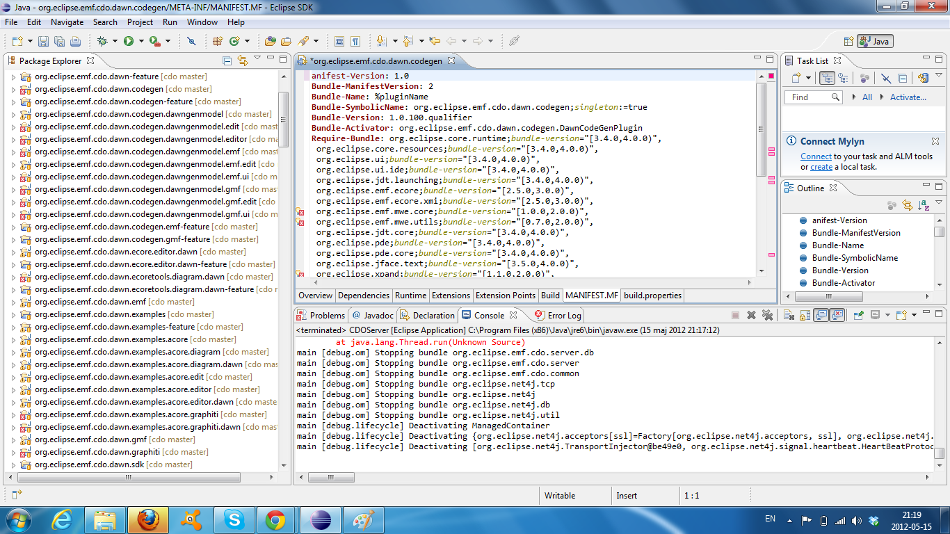

I am done with all the steps for Importing the CDO Source. Now there are some problems in some of the workspace projects.
They are:
1. Most of the dawngenmodel projects
2. cdo.tests projects
3. org.gastro projects
Also, when I try to run the CDO Server I get the following error:
[ERROR] Unknown DB adapter: h2
java.lang.IllegalArgumentException: Unknown DB adapter: h2
What configuration should I run first?

Hi Martin,
"Eclipse Clean" did not help. Please find the attached screenshot.

I can't see any exact problem marker descriptions. Why do you think this screenshot can help us to help you?

From this, you could see the projects which has problems. I thought, this might help you.
