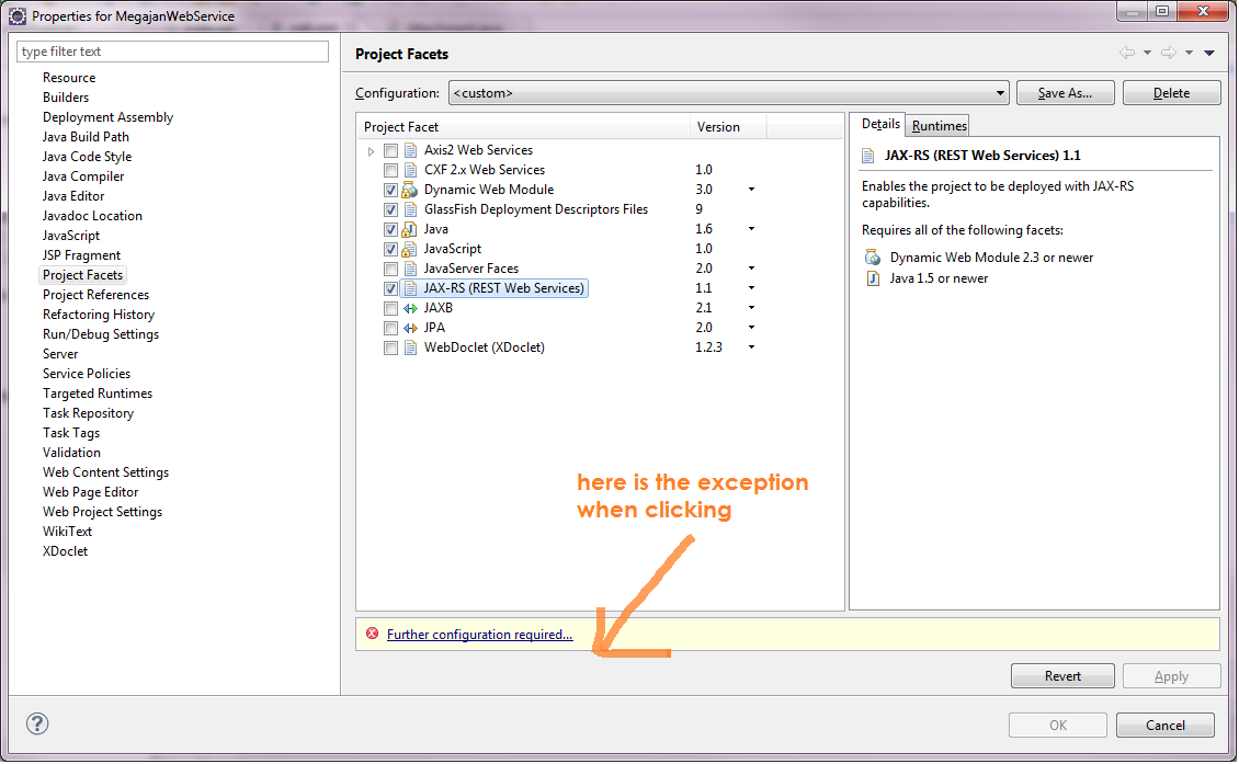

I am using Eclipse Indigio. I am trying to add JAX-RS project facet to my
Dynamic Web Project under Eclipse but it is not possible.
When I check in Project Facets the option "JAX-RS..." then appears link "Further configuration needed..."
When I click this link IDE hangs below the exception stack trace. I have no ide wher is the problem - in Eclipse IDE or in Glassfish 3.1 installation.
I have found the same problem here:
forums.oracle.com/forums/thread.jspa?threadID=2298630
Please help!

Ok. I solved the problem.
I have updated "Oracle Server Tools for Glassfish" from ver. 1.7 to 2.1 and further configuration is possible.
