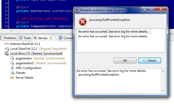

Hello all,
I've upgraded Eclipse 3.7 to the latest software. I checked all that could be updated.
Now however, I keep getting the following popup:
index.php/fa/8003/0/
Exception (copied from the Eclipse .log):
!ENTRY org.eclipse.jface 4 2 2012-04-20 08:54:58.618
!MESSAGE Problems occurred when invoking code from plug-in: "org.eclipse.jface".
!STACK 0
	at com.sun.enterprise.jst.server.sunappsrv.actions.PreludeUpdateCenterAction.accept(PreludeUpdateCenterAction.java:171)
	at com.sun.enterprise.jst.server.sunappsrv.actions.AppServerContextAction.selectionChanged(AppServerContextAction.java:238)
	at org.eclipse.ui.actions.SelectionProviderAction.selectionChanged(SelectionProviderAction.java:143)
	at org.eclipse.jface.viewers.Viewer$2.run(Viewer.java:164)
	at org.eclipse.ui.internal.JFaceUtil$1.run(JFaceUtil.java:49)
	at org.eclipse.jface.util.SafeRunnable.run(SafeRunnable.java:175)
	at org.eclipse.jface.viewers.Viewer.fireSelectionChanged(Viewer.java:162)
	at org.eclipse.jface.viewers.StructuredViewer.updateSelection(StructuredViewer.java:2188)
	at org.eclipse.jface.viewers.StructuredViewer.setSelection(StructuredViewer.java:1725)
	at org.eclipse.jface.viewers.TreeViewer.setSelection(TreeViewer.java:1139)
	at org.eclipse.ui.navigator.CommonViewer.setSelection(CommonViewer.java:377)
	at org.eclipse.jface.viewers.Viewer.setSelection(Viewer.java:394)
	at org.eclipse.wst.server.ui.internal.cnf.ServerDecoratorsHandler$1.run(ServerDecoratorsHandler.java:58)
	at org.eclipse.swt.widgets.RunnableLock.run(RunnableLock.java:35)
	at org.eclipse.swt.widgets.Synchronizer.runAsyncMessages(Synchronizer.java:135)
	at org.eclipse.swt.widgets.Display.runAsyncMessages(Display.java:4140)
	at org.eclipse.swt.widgets.Display.readAndDispatch(Display.java:3757)
	at org.eclipse.ui.internal.Workbench.runEventLoop(Workbench.java:2701)
	at org.eclipse.ui.internal.Workbench.runUI(Workbench.java:2665)
	at org.eclipse.ui.internal.Workbench.access$4(Workbench.java:2499)
	at org.eclipse.ui.internal.Workbench$7.run(Workbench.java:679)
	at org.eclipse.ui.internal.Workbench.createAndRunWorkbench(Workbench.java:668)
	at org.eclipse.ui.internal.ide.application.IDEApplication.start(IDEApplication.java:123)
	at org.eclipse.core.runtime.adaptor.EclipseStarter.run(EclipseStarter.java:344)
	at org.eclipse.core.runtime.adaptor.EclipseStarter.run(EclipseStarter.java:179)
	at org.eclipse.equinox.launcher.Main.invokeFramework(Main.java:622)
	at org.eclipse.equinox.launcher.Main.basicRun(Main.java:577)
	at org.eclipse.equinox.launcher.Main.run(Main.java:1410)
	at org.eclipse.equinox.launcher.Main.main(Main.java:1386)
Note this appears twice in the log, thus the two NPEs in the popup.
Note, that I'm using JBoss Tools. When I edit any Java file a popup dialog appears on every save operation while the JBoss 7 server is running. It could hardly be more annoying to be honest!
What's wrong here? Can this be fixed? Who's responsible?
I cannot revert to the previous install, it fails with some error that some older repos aren't found or so.
Karsten
[Updated on: Fri, 20 April 2012 03:18] by Moderator
Re: Eclipse software update: NPE popup on saving edited source [message #850649 is a reply to message #850615] Fri, 20 April 2012 03:48 Go to previous messageGo to next message
Not sure who contributes the
com.sun.enterprise.jst.server.sunappsrv.actions but it sounds like WTP?
JFace only catches the exception and logs it.
Tom

Re: Eclipse software update: NPE popup on saving edited source [message #850664 is a reply to message #850615] Fri, 20 April 2012 04:05 Go to previous messageGo to next message
Note, I'm also using the GlassFish plugins. It looks like
http://java.net/nonav/projects/glassfishplugins/lists/cvs/archive/2008-11/message/21
has reappeared. I wonder how this can happen...
Karsten
