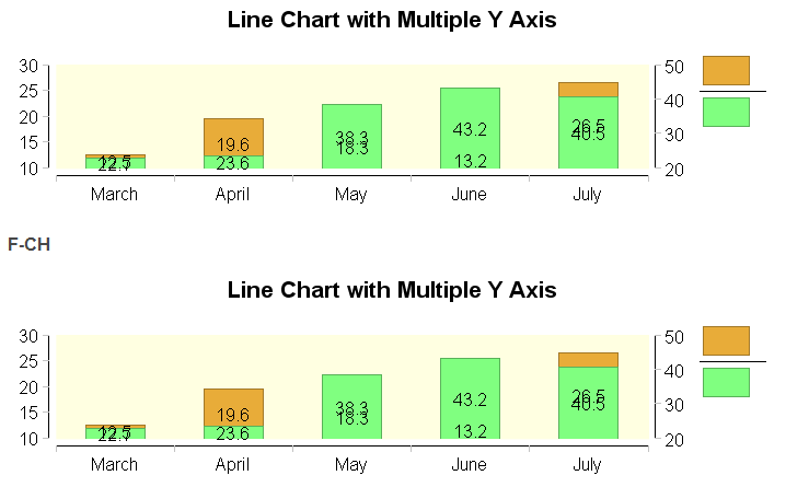

The following code can generate a bar chart (showed in attachment) with 2 y-axes. The bars are not side by side, but overlapped.
I need help, thanks!

Re: bar chart with 2 y-axes [message #850263 is a reply to message #849557] Thu, 19 April 2012 19:09 Go to previous messageGo to next message
Can you open a bugzilla. If I use the following code, a report is
created with the correct chart type with side by side set on the the two
y-axis. But it does not appear to work with standalone chart engine.
Also adding a reference to older message on similar subject:
http://www.eclipse.org/forums/index.php/m/835717/

public static final Chart createSideBySide(){
ChartWithAxes cwaBar = ChartWithAxesImpl.create();
cwaBar.setType("Bar Chart"); //$NON-NLS-1$
cwaBar.setSubType("Side-by-side"); //$NON-NLS-1$
cwaBar.getBlock().getBounds().setWidth(600);
cwaBar.getBlock().getBounds().setHeight(600);
// Plot
cwaBar.getBlock().setBackground(ColorDefinitionImpl.WHITE());
cwaBar.getPlot().getClientArea().setBackground(ColorDefinitionImpl.create(255,
255, 225));
// Title
cwaBar.getTitle().getLabel().getCaption().setValue("Bar Chart with
Multiple Y Axis");//$NON-NLS-1$
// Legend
Legend lg = cwaBar.getLegend();
LineAttributes lia = lg.getOutline();
lg.getText().getFont().setSize(16);
lia.setStyle(LineStyle.SOLID_LITERAL);
lg.getInsets().set(10, 5, 0, 0);
lg.getOutline().setVisible(false);
lg.setAnchor(Anchor.NORTH_LITERAL);
// X-Axis
Axis xAxisPrimary = cwaBar.getPrimaryBaseAxes()[0];
xAxisPrimary.setType(AxisType.TEXT_LITERAL);
//xAxisPrimary.getMajorGrid().setTickStyle(TickStyle.BELOW_LITERAL);
//xAxisPrimary.getOrigin().setType(IntersectionType.MIN_LITERAL);
// Y-Axis
Axis yAxisPrimary = cwaBar.getPrimaryOrthogonalAxis(xAxisPrimary);
//yAxisPrimary.getMajorGrid().setTickStyle(TickStyle.LEFT_LITERAL);
yAxisPrimary.setType(AxisType.LINEAR_LITERAL);
yAxisPrimary.setSideBySide(true);
// Y-Axis (2)
Axis yAxis = AxisImpl.create(Axis.ORTHOGONAL);
yAxis.setType(AxisType.LINEAR_LITERAL);
//yAxis.getMajorGrid().setTickStyle(TickStyle.RIGHT_LITERAL);
//yAxis.setLabelPosition(Position.RIGHT_LITERAL);
xAxisPrimary.getAssociatedAxes().add(yAxis);
yAxis.setSideBySide(true);
// Data Set
TextDataSet categoryValues = TextDataSetImpl.create(new String[] {
"March", "April", "May", "June", "July"
});//$NON-NLS-1$//$NON-NLS-2$//$NON-NLS-3$//$NON-NLS-4$//$NON-NLS-5$
NumberDataSet orthoValues1 = NumberDataSetImpl.create(new double[] {
12.5, 19.6, 18.3, 13.2, 26.5 });
NumberDataSet orthoValues2 = NumberDataSetImpl.create(new double[] {
22.7, 23.6, 38.3, 43.2, 40.5 });
SampleData sd = DataFactory.eINSTANCE.createSampleData();
BaseSampleData sdBase = DataFactory.eINSTANCE.createBaseSampleData();
sdBase.setDataSetRepresentation("");//$NON-NLS-1$
sd.getBaseSampleData().add(sdBase);
OrthogonalSampleData sdOrthogonal1 = DataFactory.eINSTANCE
.createOrthogonalSampleData();
sdOrthogonal1.setDataSetRepresentation("");//$NON-NLS-1$
sdOrthogonal1.setSeriesDefinitionIndex(0);
sd.getOrthogonalSampleData().add(sdOrthogonal1);
OrthogonalSampleData sdOrthogonal2 = DataFactory.eINSTANCE
sdOrthogonal2.setDataSetRepresentation("");//$NON-NLS-1$
sdOrthogonal2.setSeriesDefinitionIndex(1);
sd.getOrthogonalSampleData().add(sdOrthogonal2);
cwaBar.setSampleData(sd);
// X-Series
Series seCategory = SeriesImpl.create();
//seCategory.setDataSet(categoryValues);
seCategory.getDataDefinition( )
.add( QueryImpl.create( "row[\"PRODUCTCODE\"]" ) );
SeriesDefinition sdX = SeriesDefinitionImpl.create();
xAxisPrimary.getSeriesDefinitions().add(sdX);
sdX.getSeries().add(seCategory);
// Y-Series (1)
BarSeries bs1 = (BarSeries) BarSeriesImpl.create();
//bs1.setDataSet(orthoValues1);
bs1.getDataDefinition( ).add( QueryImpl.create(
"row[\"QUANTITYORDERED\"]" ) );
bs1.getLabel().setVisible(true);
//bs1.setLabelPosition(Position.INSIDE_LITERAL);
bs1.setStacked(false);
SeriesDefinition sdY1 = SeriesDefinitionImpl.create();
sdY1.getSeriesPalette().shift(-2);
yAxisPrimary.getSeriesDefinitions().add(sdY1);
sdY1.getSeries().add(bs1);
// Y-Serires (2)
BarSeries bs2 = (BarSeries) BarSeriesImpl.create();
//bs2.setDataSet(orthoValues2);
bs2.getDataDefinition( ).add( QueryImpl.create(
bs2.getLabel().setVisible(true);
//bs2.setLabelPosition(Position.INSIDE_LITERAL);
bs2.setStacked(false);
SeriesDefinition sdY2 = SeriesDefinitionImpl.create();
sdY2.getSeriesPalette().shift(-3);
yAxis.getSeriesDefinitions().add(sdY2);
sdY2.getSeries().add(bs2);
return cwaBar;
> // Plot

Re: bar chart with 2 y-axes [message #853627 is a reply to message #850263] Mon, 23 April 2012 03:27 Go to previous messageGo to next message
Thank you very much, i have just tested it, it works. but in my Webapp i need to work with standalone chart engine. I need charts saved as .png in my xhtml site.
is this a bug of Birt?
Re: bar chart with 2 y-axes [message #854326 is a reply to message #853627] Mon, 23 April 2012 18:02 Go to previous messageGo to next message
Yes it is a bug. Can you log it? It looks like the error is in the Bar
class
public BarAxisIdLookup( ChartWithAxes cwa, Axis curAxis )
Axis[] axs = cwa.getOrthogonalAxes( cwa.getBaseAxes( )[0], true );
int count = 0, id = 0;
for ( Axis axis : axs )
if ( axis.isSideBySide( )
&& axis.getSeriesDefinitions( ).size( ) > 0 )
SeriesDefinition sd = axis.getSeriesDefinitions( ).get( 0 );
if ( sd.getDesignTimeSeries( ) instanceof BarSeries )
if ( curAxis == axis )
id = count;
count++;
The issue with this is that sd.getDesignTimeSeries returns null for
charts that manually set the data and thus not allowing side by side.
Jason
> in my xhtml site.
